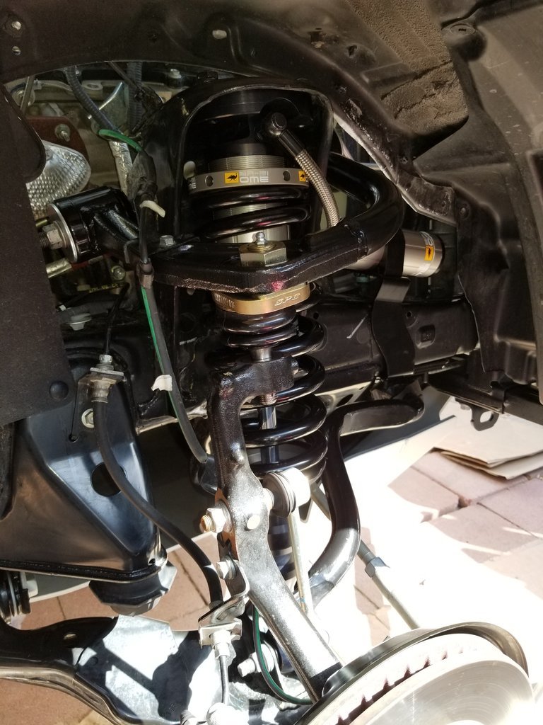

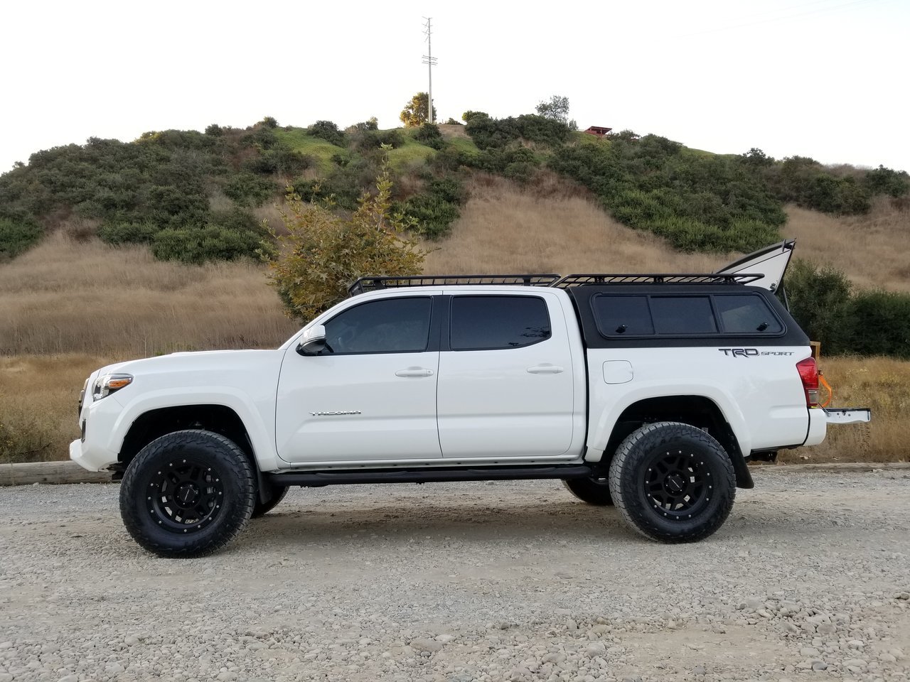

    Which OME lift are you referring to... I'm running bp51 with 33's. I rub just ever so slightly when turning on some uneven surfaces on my aftermarket mudguard. I feel if I took that guard off it wouldn't rub at all. I'm pretty sure though I'm higher than just 2 inches though on this suspension. By the way wheel specs help too. 17 x 9 with -6 offset. 20171007_071636.jpg 20171001_145704.jpg

    This is one of the only pictures I have but I'm running the OME 2 inch heavy suspension with the nitrochargers. The wheels are rotiform SIX-OR's and 33 inch tires. Not sure on the offest but the back spacing is 5 inches for sure. They do not rub at all since I have removed the front mud flaps. No cab mount chop or anything. Hope this helps dude.

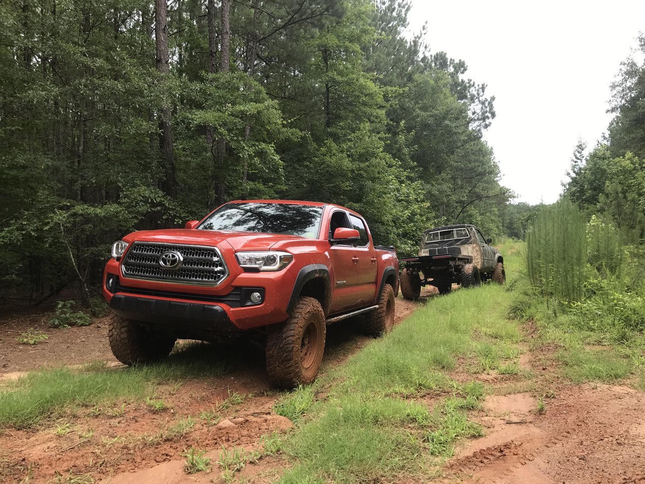

    285/75/16 4.5 backspace ome 2" lift with grabber x3
    No rub whatsoever off road full and half "cut" loaded down and unloaded ... but I've found that I get bubb rub when parked.
