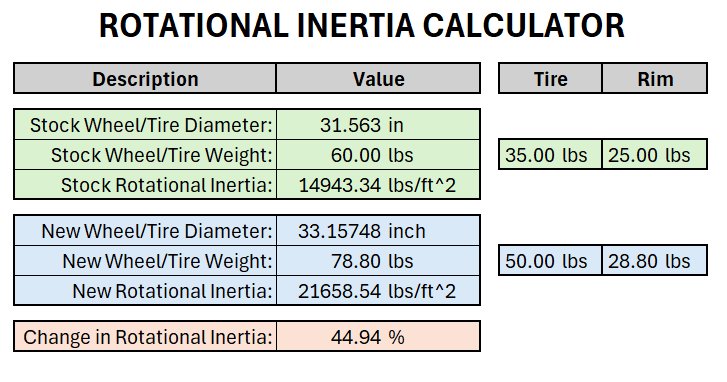

    I've been thinking allot about this topic, how much performance in acceleration/braking do you lose when changing tire size (mass). Although not perfect, I've tried approaching this by doing a simple Moment of Inertia calc for comparison between stock and larger Rim/Tire selections. I'm hoping to get a general understanding of how much extra power does it take to accelerate different size setups relative to stock. Looks like this in my spreadsheet so far:
    If anyone is interested in my spreadsheet, it's attached, feel free to grab it and evolve it for your own application. I find it helpful in scenario modeling, when you can find accurate weight information on Rims/Tires.
    I've noticed the more aggressive off-road tires are ungodly heavy compared to stock A/S tires. This soaks power and braking performance by the numbers and I've experienced this in real-world applications in the past. This "engineered" approach allows me to quantify it to a degree.
    Cheers!

    Ooh, I love this. So much thrown around here based on anecode and opinion, then we get real data from a critical thinker, who also acknowledges the method's imperfection. Thank you for elevating the discussion to rational.
    I'm hoping you know the physics better than me and can add your thoughts on this question. I think that moment of inertia calculations assume that the mass is all out at the periphery of the distance upon which the force is applied. The wheels and tires however distribute that mass with a center of mass closer to the center of rotation. Is there any way to account for this in your calculations? If I'm right (unlikely perhaps) then I think your calculation would be overestimating the increase in rotational inertia with increased tire weight?
    You'll soon get questions about effect on MPG, and I have a feeling that involves so many variables it would be impossible to come close to calculating. But if you can do it you'll get a TW Nobel.

    Heh, heh, thanks for the kind words Roalddahl!
    So the point you raise of the position of the mass is at least one of the flaws in this study, however the flaw is consistent between the stock and modified scenarios, so it at least represents the relative change, you just have to take the resulting number with a grain of salt. This study, due to the simplistic nature of the equation I chose to use, takes the mass and averages it equally across the rotational radius. To do anything any more complex requires me to move more towards a three-dimensional model. Similarly, my simple model does not take into account factors such as frictional losses within the drivetrain when changing loads, differences in coefficient of friction in the two different tires which potentially creates additional rolling drag, aerodynamic differences and so forth...all of which can play some minor role in the accuracy of the model.
    I'm hoping this concept can inspire somebody to take it to another level of accuracy from where I left off.

    How did you find the center of mass (or rotational equivalent)? Wouldn’t the distribution of weight be vital to accurate calcs?
