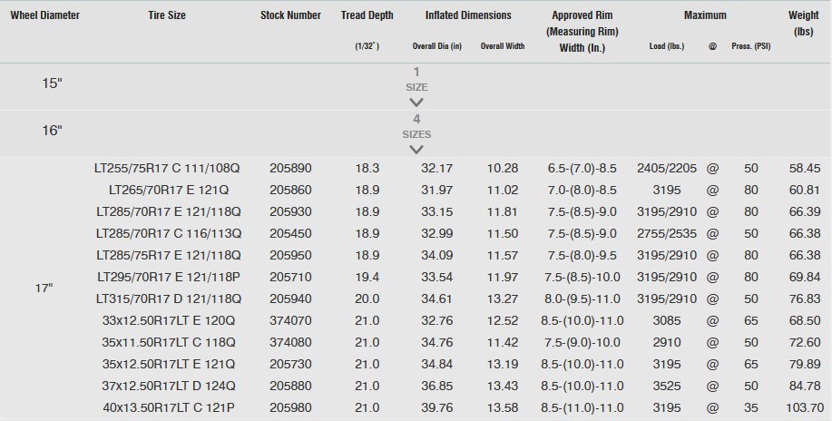

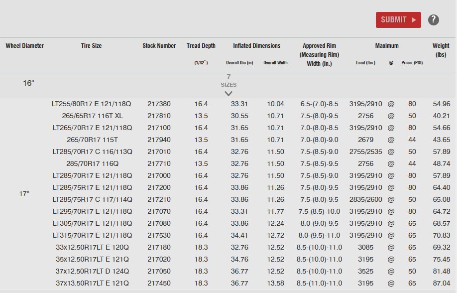

    Jul 15, 2018

    Interco IROK ND in 8ply.
    Maxxis Bighorn MT-762 D-range
    Maxxis Bravo Series AT-771 D-range
    Pirrelli Scorpion ATR D-range
    Nitto Terra Grappler D-range listed as a 32.68"
    As what happened with 15" 16" may be seeing the same fate.
