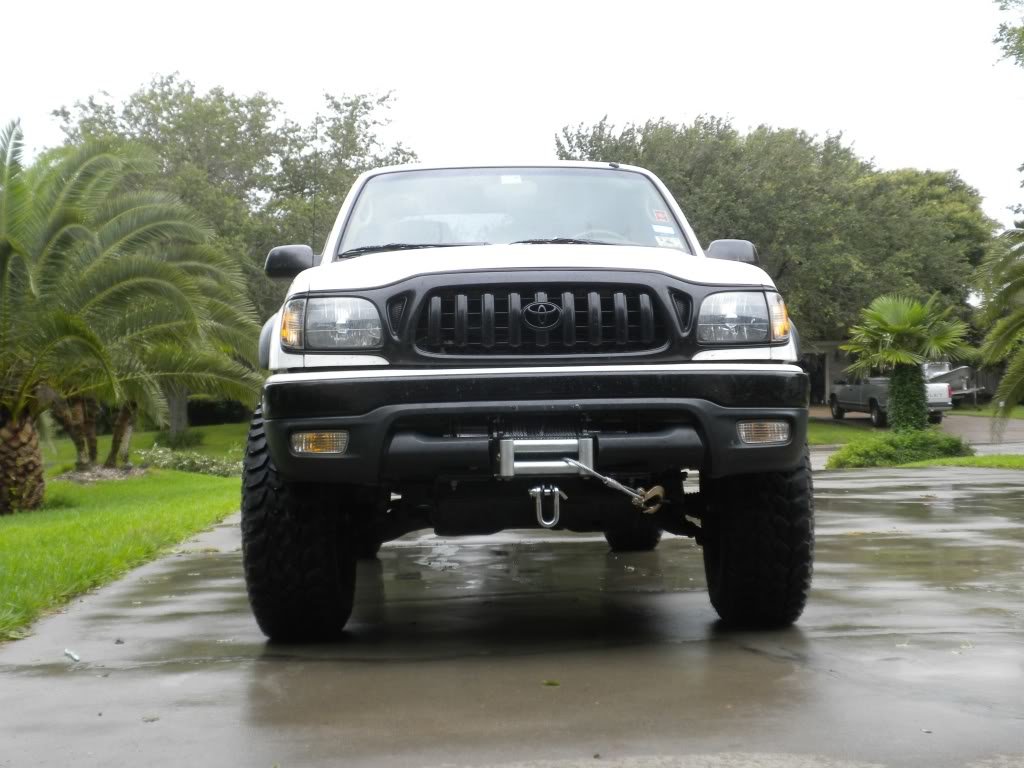

    3 in Ultimate ToyTec, set @ 2.5 in. AAL PINCH Weld Mod ( beat the pinch weld over inside the fender) Painted the pinch weld on bottom of cab Black Hi Lift Knock off
    Back Space is the key to getting 33s to fit without trimming
    Mine is at 2.5 to 3 , no trimming, rubs on frame a little when I steer against the lock going left because my rims are 4.5 in back space
    Here is a pic
