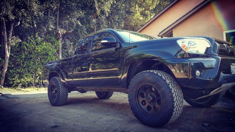

    looks GREAT brotha!

    I had to remove front mini flaps, remove reg mud flaps, and trim some of the plastics on the inner fender liner as well as trim the cab mount and flatten the pinch weld. it wasn't an issue on normal driving but whenever I went to the desert I would rub. so it is HEAVILY clearanced

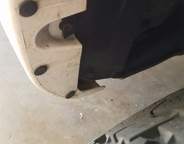

    I had to take off the mud flaps (even the little one in the front) and very minor trimming 20161208_125236.jpgIt was two years ago and I can't remember what I had to trim but not much. Now I don't even see what I cut. Each truck is going to be a little different. I have the bilstein 5100 set at 2.5 with stock springs and stock uca. My factory caster adjustment is maxed. If you do adjustable uca then it will push the tire back more. You don't have room to spare. I will be upgrading my suspension with uca. My "plan" is to max out the factory caster adjustment and see how much the factory camber adjustment will adjust caster too. Basically move the lower ball joint as far forward as possible. Then use the adjustable uca to correct camber and caster. I'm thinking it's going to be a dance back and forth to get the alignment/tire placement where I want it. You'll have to find an alignment person who is willing to work with you. I'm going to do all this to minimize cutting and cmc. The alternative is buy the tires you want, set the alignment however you want and cut whatever is in the way. That is the way most people do it (I think) but I'm willing to do the extra work to minimize what has to be trimmed.
