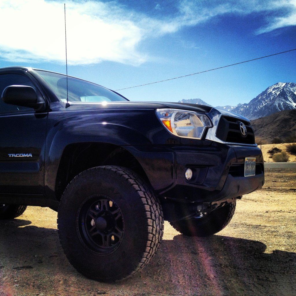

    285/75 no trimming, just removed the flaps. Just a tad bit of rub flexed full lock.

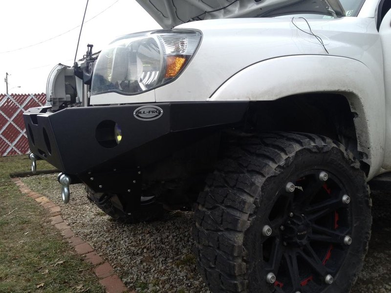

    Im running 33x12.50x20 mud grapplers with a 3in lift. I can tell that i lost some power but i can still pull my 3000# boat trailer around without any problems. I get ~18 mpgs.

    Oh and my 33's rub big time. i had to chop my cab mounts and do a lot of trimming. They still rub on my uca's when flexed.
