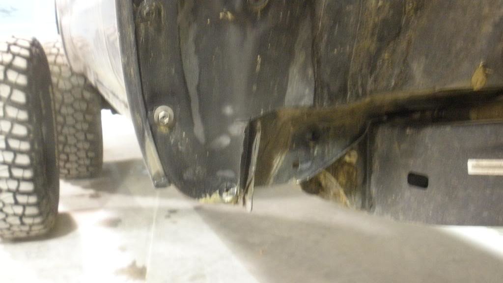

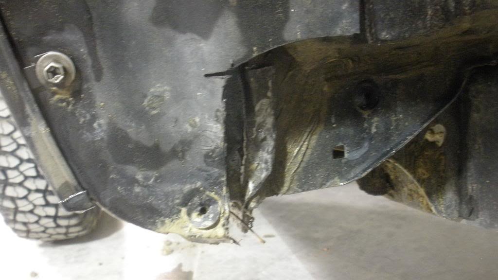

    No no you don't have to cut the flares. Just the wheel well. Ill post pics later. Or just search pinch weld mod

    Yeah, the pinch weld mod will be a huge help.
    You may still encounter some rubbing while flexing it offroad, but at least you'll be able to drive it properly and go around corners without hearing scraping. :)

    Yea just the inside of the wheel well

    I used a pocket knife for the plastic and then a grinder to cut the metal to hammer it flat.

    You might have to air down a bit. Do the chalk test.
    and Mark, you don't need a grinder i think, i just used it so it would fold over a bit better and trimmed a little off the bottom as well. And i used a knife cause...what else would you use?? and who cares how bad it looks, i don't see ppl sticking their heads in ppls wheel wells..
