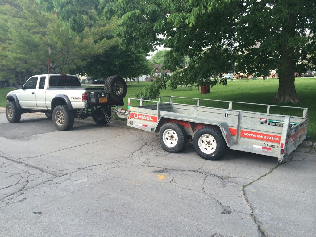

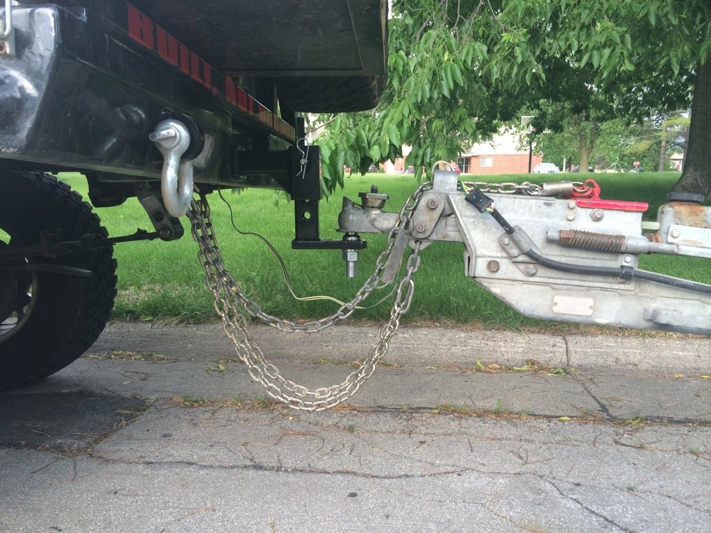

    I tow with mine. The biggest issue you will have is needing to drop your ball a lot. I had a 7.5" drop on mine and it wasn't nearly enough, but it worked. I could swing open my swingout just fine with the trailer I had.

    same here - 12" drop hitch for mine.
    swing out is unaffected

    What's the dimension from bumper to propane tank?

    My swingout would not clear even close to 30". I think you will clear the jack handle though. You may need to go with one of the dual swingout setups. I would almost suggest a hitch extension tube, but it already looks like you are nose high and it would make that worse.
