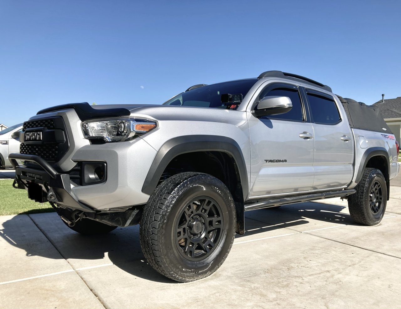

    18 Tacoma TRD off road OME BP51 front Fox 2.0 Resi rear OME Dakar Meduim Yoko G006 325/75r16 Black Rhino stadium wheels Cali raised ditch light brackets Baja Designs S1 pods Baja Designs Squadron SAE fogs Prinsu Cab rack TRD Pro grille AVS rain guards Backwoods adventure mods hi-lite bumper BL Apex 12k winch Dobinsons 4x4 snorkel Sy-clone prefilter ARB rear diff breather relocation RRW rock sliders RCI full skids At the helm bed stiffeners lil b LCA skids Warfab Phantom rear bumper Warfab tie rod sleeves C4 fender liners Dirt king UCA Duro bump stops
    285/75r16 KO2
    Bilstein 5100 set at the top with a 1/4 spacer for taco lean. It gives me 2” in the front.
    Icon 1.5” AAL in the rear.
    I’m on stock OR rims which are +25 offset. So I’m running 1.25” spider traxx which gives me -6 offset. The sweet spot is 0 to -10 offset for 285s
    This is all the cutting I had to do and no CMC.
    I’ll probably end up on 35” but this is my daily and I have to travel state to state sometimes. So I rather not get into all the stuff I have to do for that until I get a 4Runner.
    toku58, kas2828 and maplefins[OP] like this.

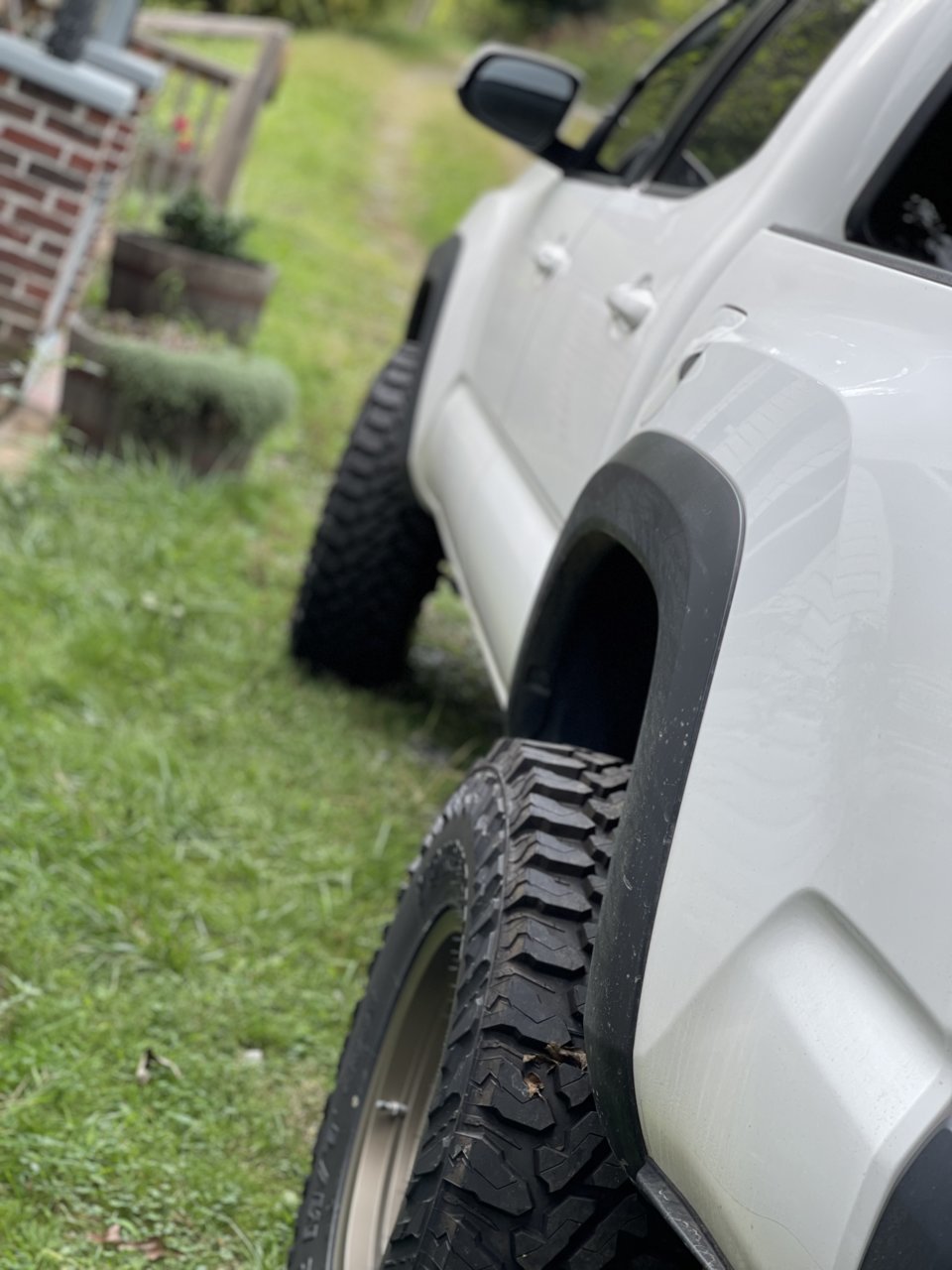

    285/75r16 with OME Lift. Viper cut up front, positive caster to clear the rear. No chopping on the rear of the front fender area or CMC.
