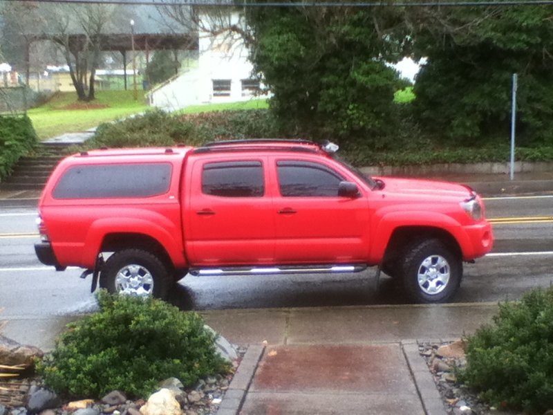

    Cooper Discoverer ST MAXX 255/85/16 (roughly 33"). Stock wheels with Spidertrax spacers. Rear- Recall spring set, AAL, airbags. Front- 5100s, OME 884.
    Without spacers, rubbed UCA, mudflaps, and bumper. With spacers, rubs mudflap on compression during a turn, trimmed bumper and fender liner to clear.
