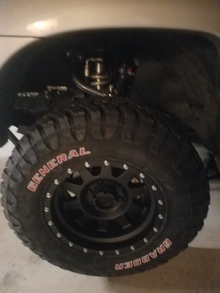

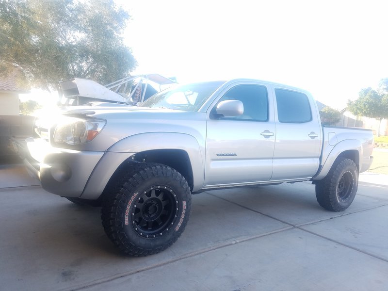

    285 is a 32.7" tire. I have 285/70R 17 on a 17x9 wheel. have Fox coilovers set at 2.5 with Total Chaos UCAs. I had to trim plastic and doing the Cab Mount Chop this week. It rubs pretty hard at full turn in reverse.20170302_001501.jpg 20170302_170922.jpg
