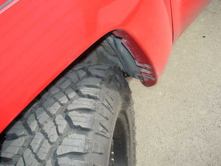

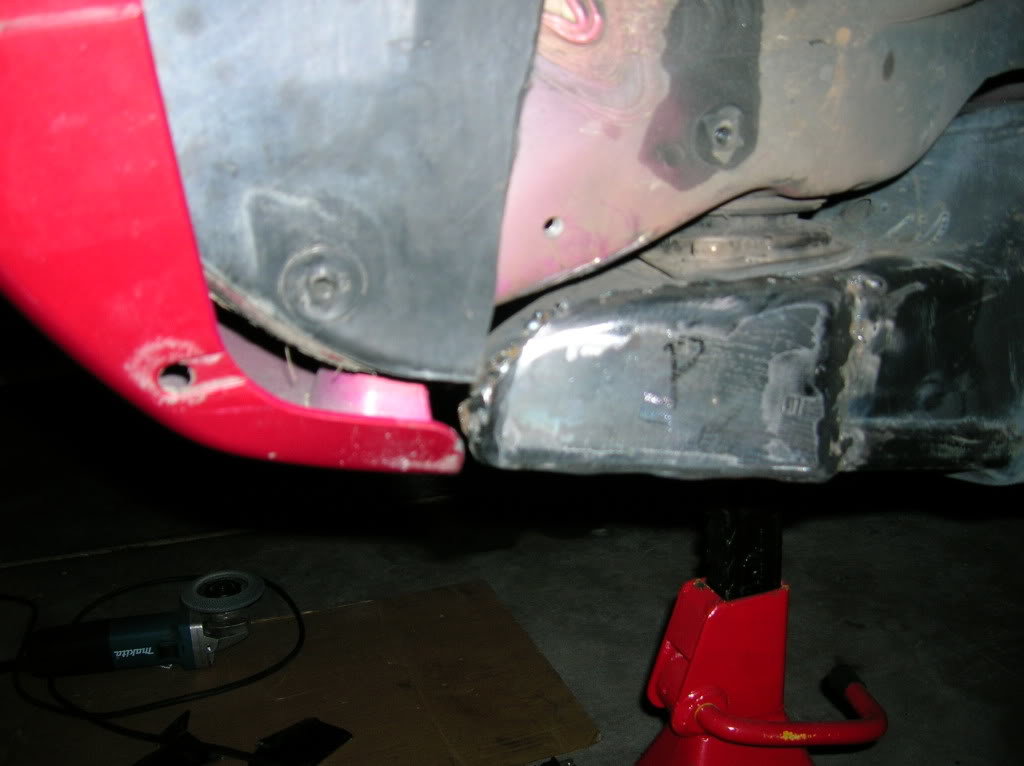

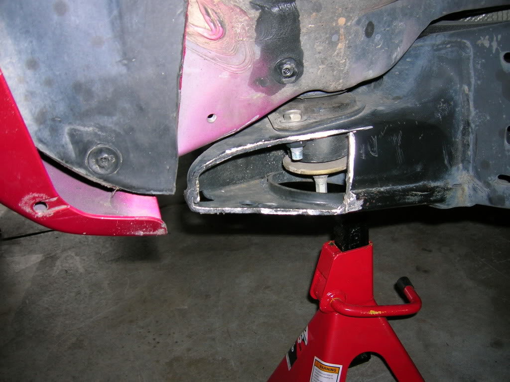

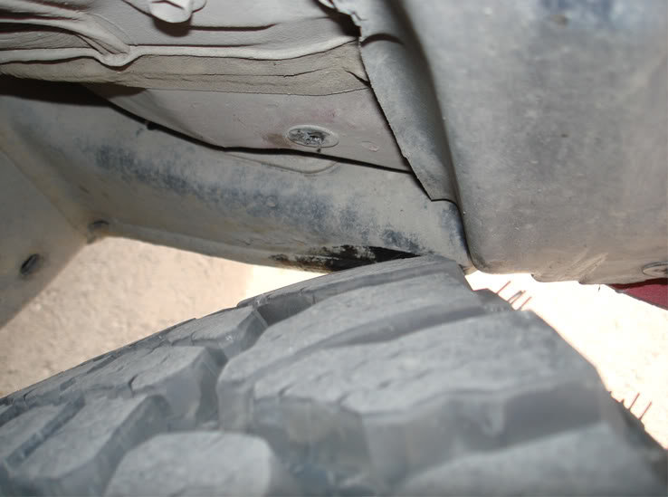

    Yeah, with aftermarket UCA's (which I recommend) you do get more positive caster, which on compression of the suspension will push the tire more toward the rear of the wheel well. At ride height, the center of the wheel will be in the same spot, and on extension of the suspension (droop), the wheel/tire will actually move more toward the front of the wheel well.
    Nevertheless, with 285/75R16s or 285/70R17s you'll still likely have some rubbing on the cab mount part of the frame at the rear of the wheel well when turning and compressing the suspension. In other words, if you are turning the wheel, and hit a bump, it might rub (probably will rub). Many have done the cab mount frame mod to fix this. It is not complicated.
    Some pics to explain. Shots of the common rubbing spot.
    Fix:
