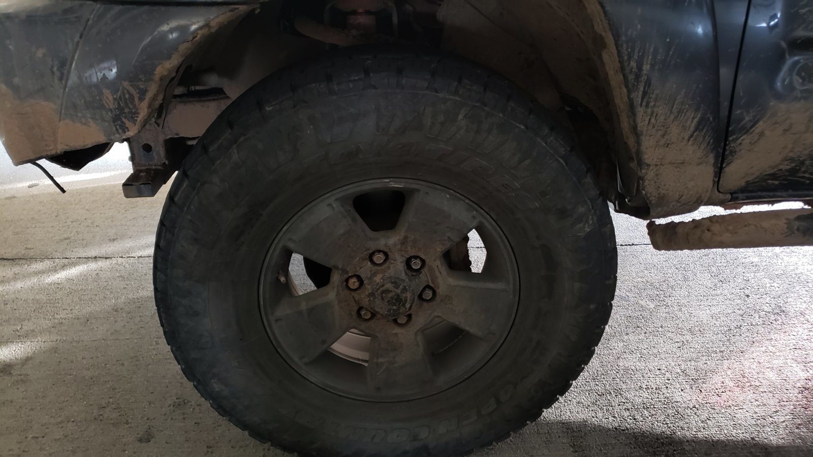

    Try a 275/70/16. 285/75_16 is closer to a 34", I have 3 inch lift, spidertrax 1.25 spacers, jba UCAS and rub horribly when offroading. Rub fenders,and frame, have hit so hard popped my fender flares off. Yi would highly recommend not going that big on stock height.

    If u dont put spacers tire will hit UCA's. Either rub on body or,frame or UCA pick your poison. 265/75/16 r. Better fit for stock height.

  12. May 14, 2024 at 5:43 PM
    SethM
    SethM Well-Known Member
    Dec 2, 2022
    #412174
    253
    Seth
    Los Angeles ca
    2011 mgm tacoma trd sport 4x4
    3" toytec lift 285/75/17" tires

    285/75/17

    Is that a viper cut on a 2011?

    As close to a viper cut as I could get

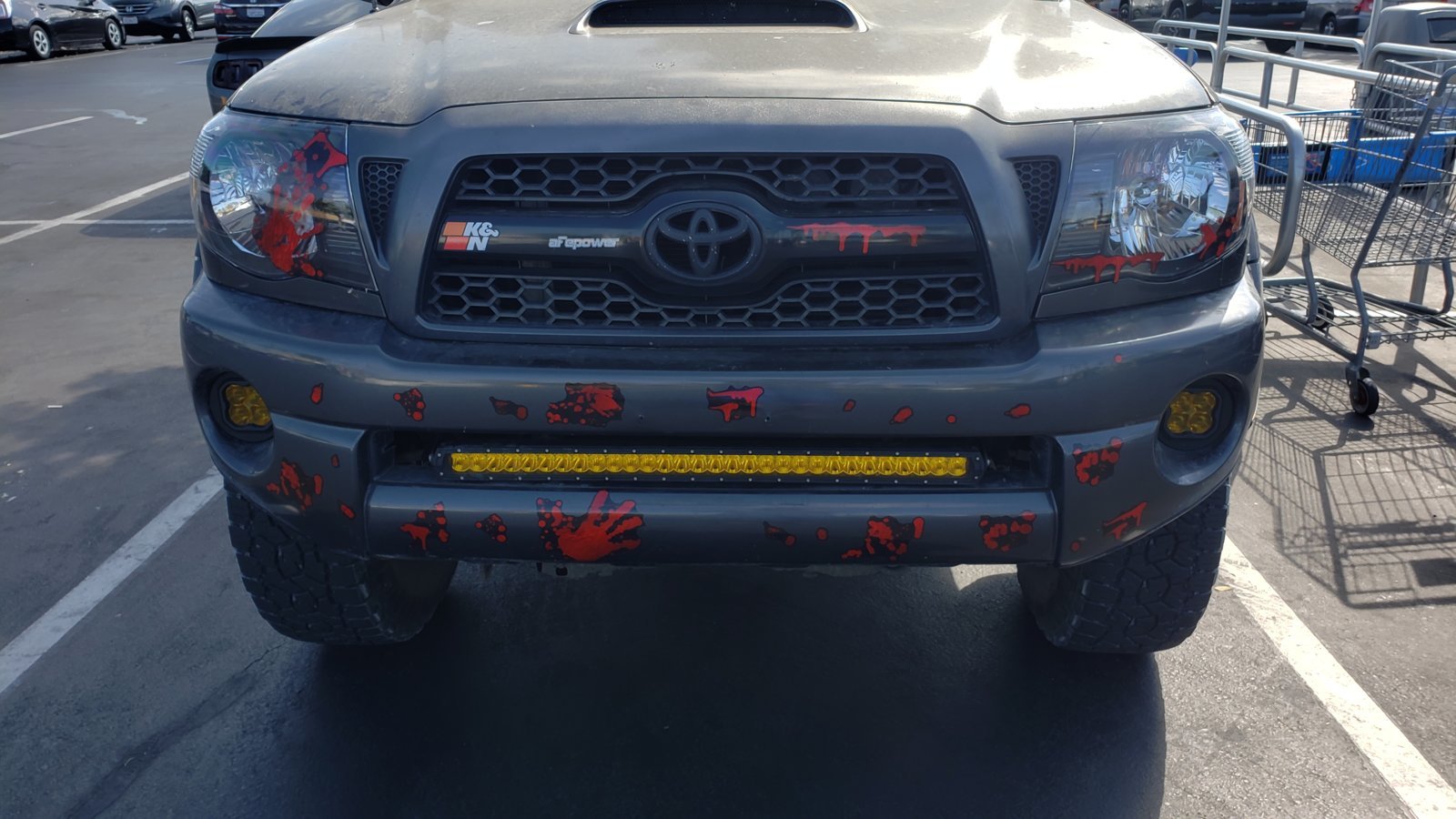

    Sorry to get off topic but what light bar is that lol

    Amazon big lionx $50, cant complain not gonna spend $500+ on brand name light bar
    Brackets r also Amazon special

    Thanks! Yeah thats exactly what I've been thinking. Tough to find one that matches the yellow from my SS3 fogs, a lot seem to be too orange or too neon/almost green tint.
