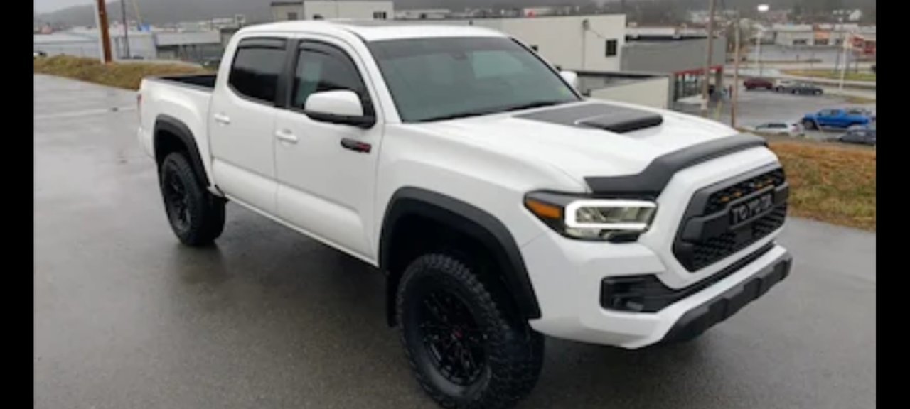

    Well I couldn't find a 2023 TRD Pro that they weren't asking less than 5k over MSRP so I bought a 21.
