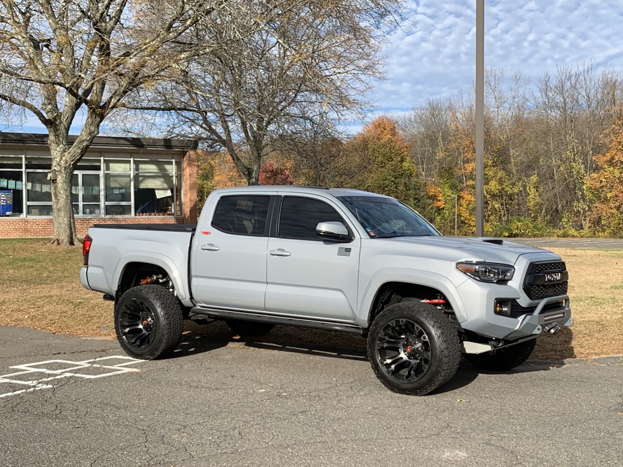

    ^^ same as above: You will likely need the CMC plus the pinch weld cut and inner plastic fender trimming (easy to mold back with a heat gun). Even if you can "fit" 33's without the CMC/trimming, it will almost certainly rub at full lock or when suspension flexed off road and drive you nuts like it did to me. Besides once you drive around on 33's, 35's will probably be on your list of upgrades.
    I'm running 20x12 with 285/55R20 which are just under 33" and have no rubbing what so ever. I have the CMC, pinch weld cut + lots of inner well plastic trimming. IMO you should just do the CMC and trimming.

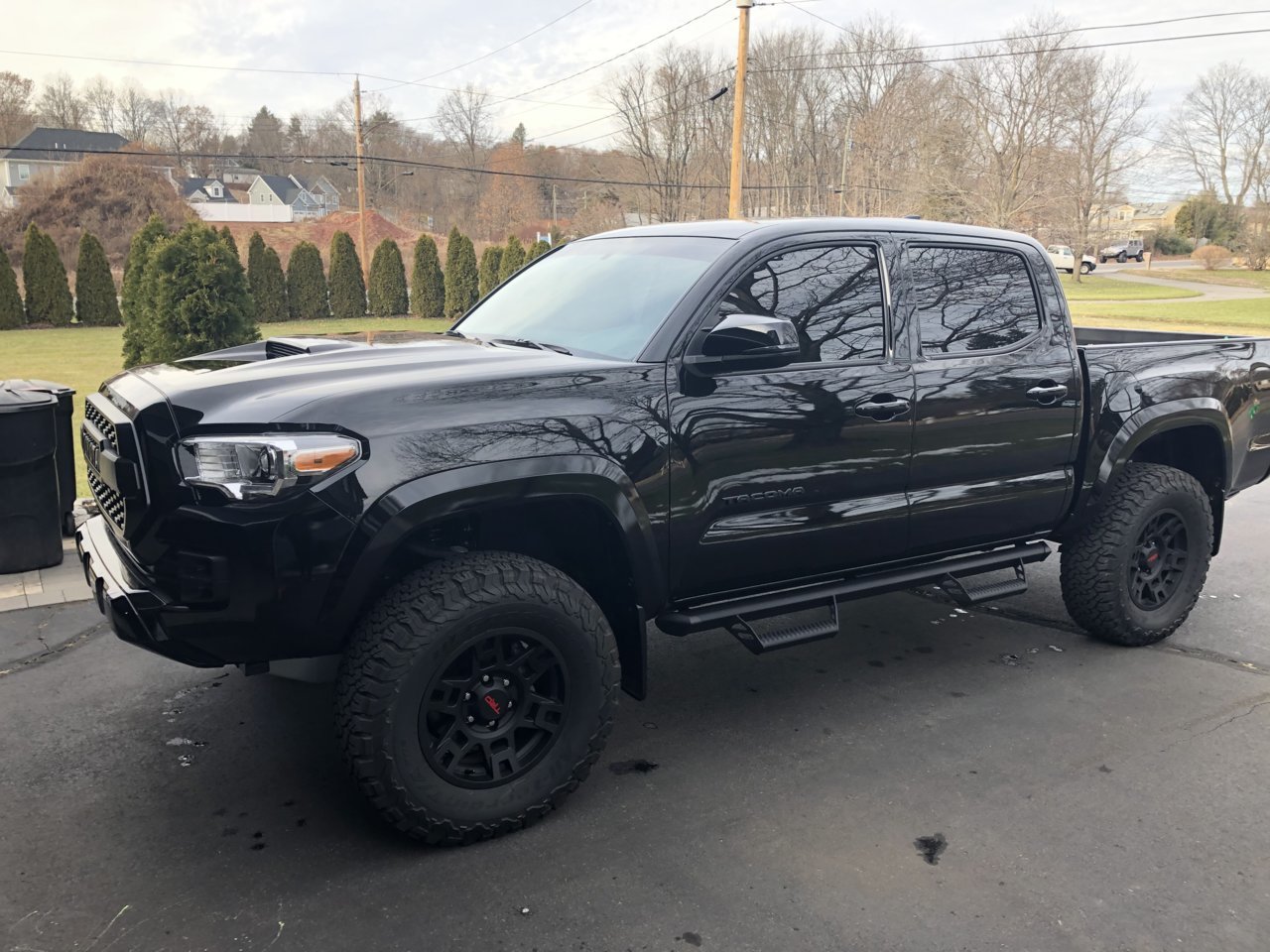

    I have a 3" lift as well, the issue I believe comes down to the rims and their off-set. I have the 17" TRD 4-Runner rims with BFG K02's on 285/70/17 and there is no rubbing at all no CMC or anything like that.
