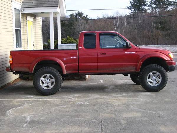

    One of my favorite first gens on TW, Member Mixaro
    255/85R16

    now im thinkin about goin 255/85/16 instead of 285/75/16, those look real good on there
