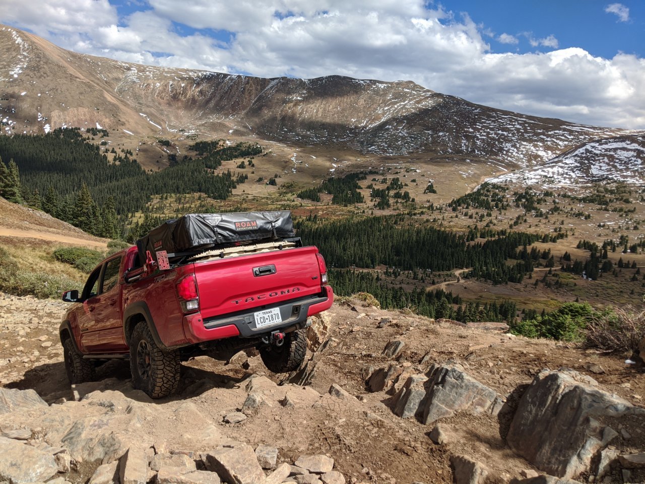

    Kings 2.5 front/rear, ICON RXT, RR2-s, 285/75/17 KO2
    In this picture i had Bilstein 6112s with 650 coils at 6/5 and fox 2.0 rears on Dakar HD leafs. And SPC UCAs. That was giving me somewhere around 2.75" Have since switched over to kings. Thanks man!

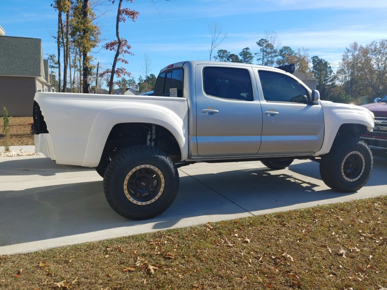

    Dont waste time on 34s. I went from a 285/75/17 to a 35x11.5x17 same toyo at3 load c. Basically a 285/80/17.
