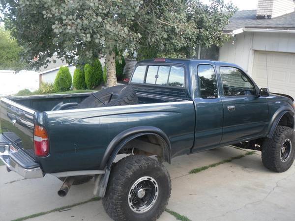

    if your going to drive 130 miles a day then go for the 33 inch they look good i have the same set up you want on my truck its not a new gen but you can see the idea [​IMG]
