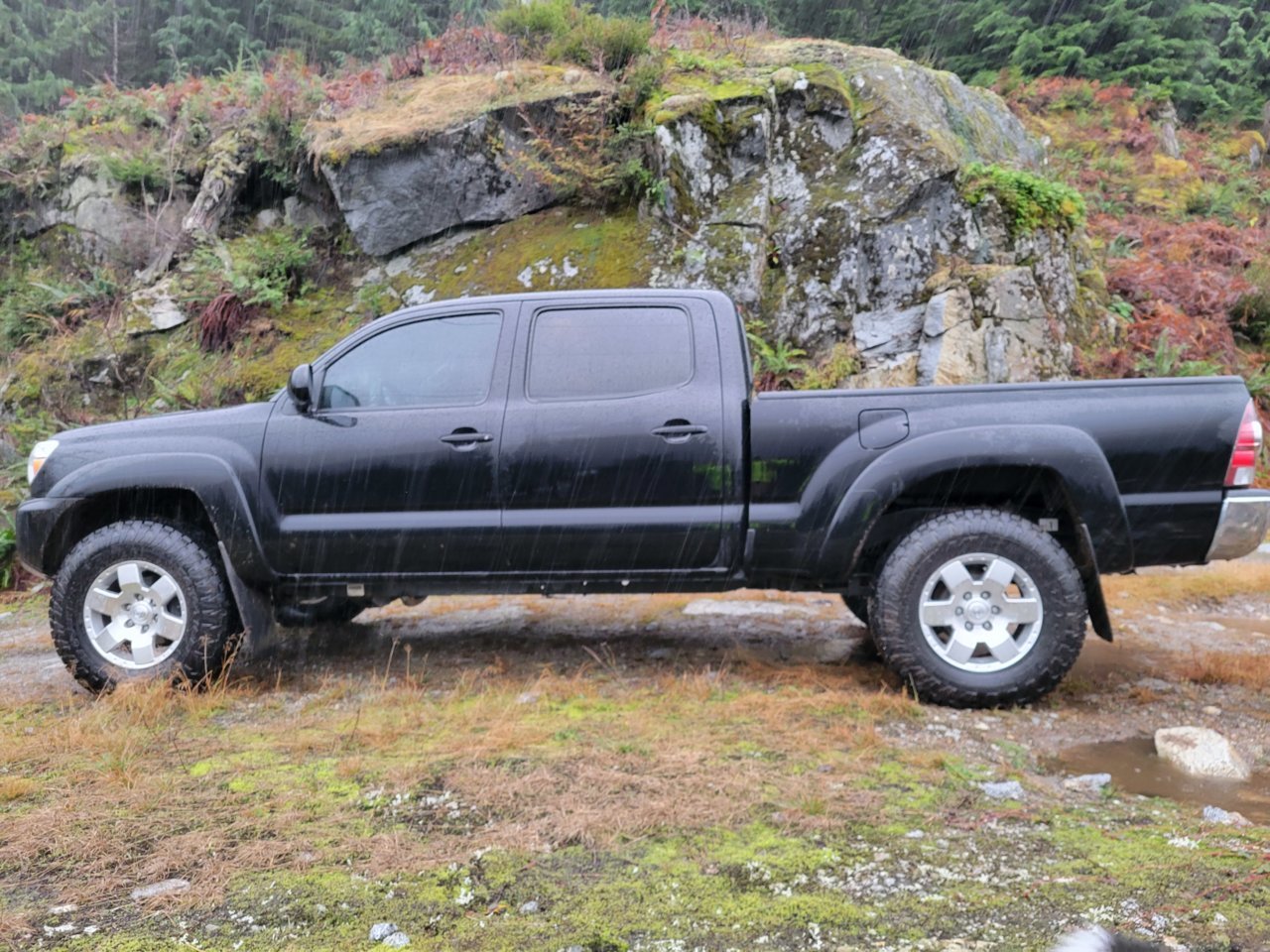

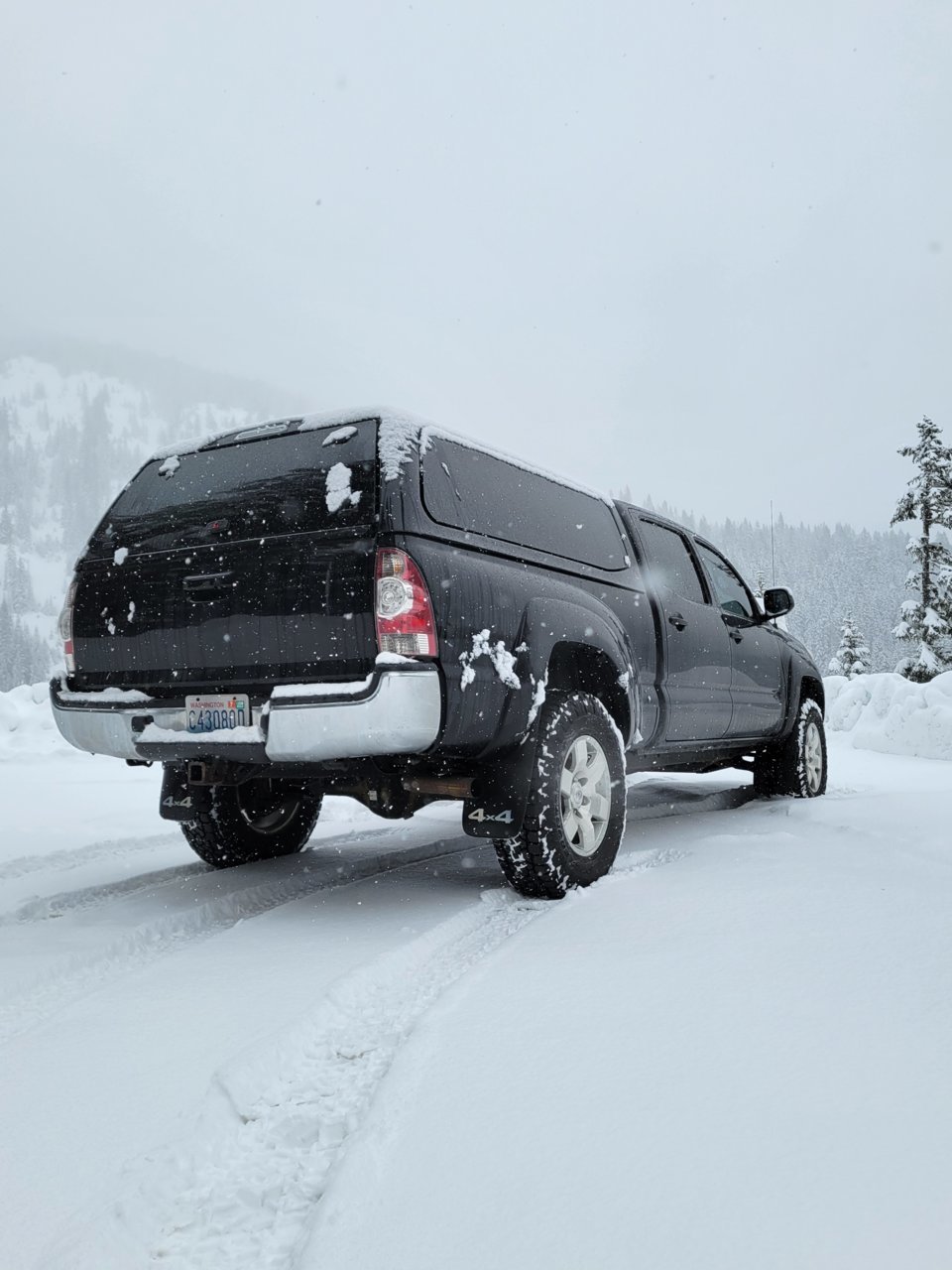

    14,188
    Alex
    WA
    2015 DCLB
    I have a similar setup
