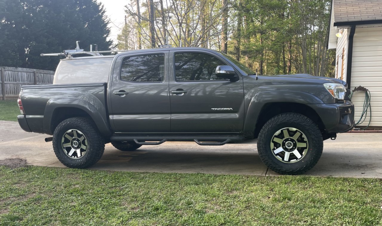

    I just put Falken Wildpeak 285/70r17 ‘s on my 2014 with 2” puck lift up front and 1” block lift in the back. Only rubbing I got was while backing up and turning. Tiny little trim to the rear plastic and it’s good to go. Note I do have 4Runner wheels with a different offset than stock. 43715A26-31F1-4C4F-BF11-909F449FFF09.jpg

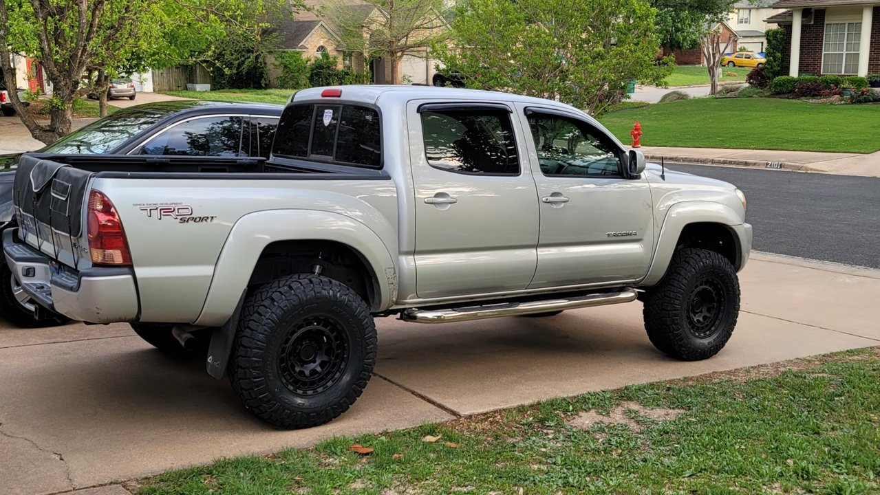

    I did a 3/2in lift on my '05 with -10mm offset and 285/75R/16 Ridge Grapplers. There was slight rubbing that required plastic to be trimmed. However, I turn too soon coming in the driveway and hit the curb and there was some rubbing. I have not gotten it off-road yet. But my assumption is that I will end getting a body mount chop done.

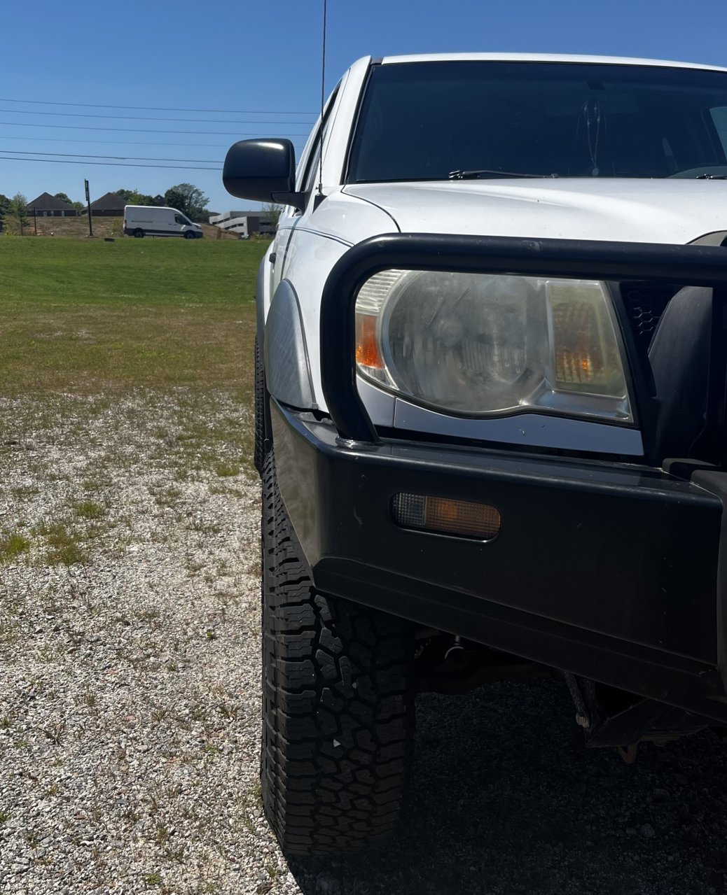

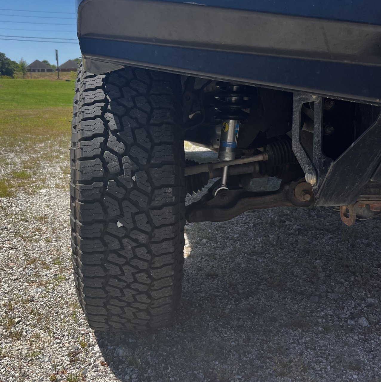

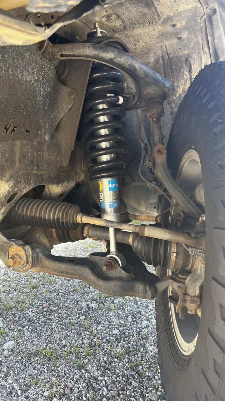

    Yessir, sorry it took so long.
    Wheels are SR5 4Runner wheels I got for $50 and poorly spray painted black. Tires are Falken Wildpeak AT3s in 255/80r17. Lift is Bilstein 5100s front and rear, with OME 885 coils and an AAL in the rear. At some point I may adjust the coilovers up 1 notch to lift the front just a hair. PassSideProf01.jpg
    I believe these 4Runner wheels have a +15mm offset in a 7in wheel, and these tires come to 10.5 or so inches wide. The sidewalls sit almost perfectly flush with the fenderwells.
    The Falken AT's have performed great, and I've really come to love the look as well.
    Drivers side suspension. With the ARB bumper, and the narrow wheel/tire, there's plenty of room in here and no rubbing I've experienced so far.
