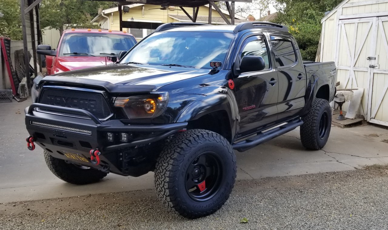

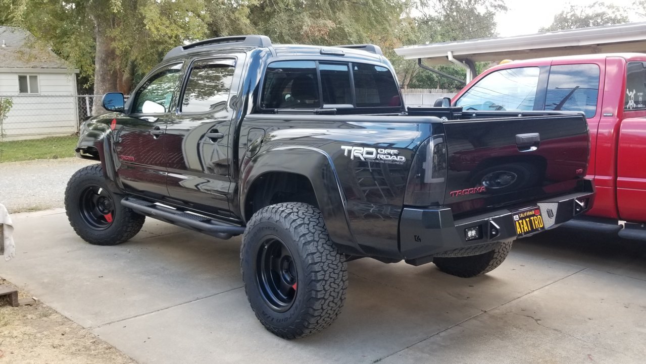

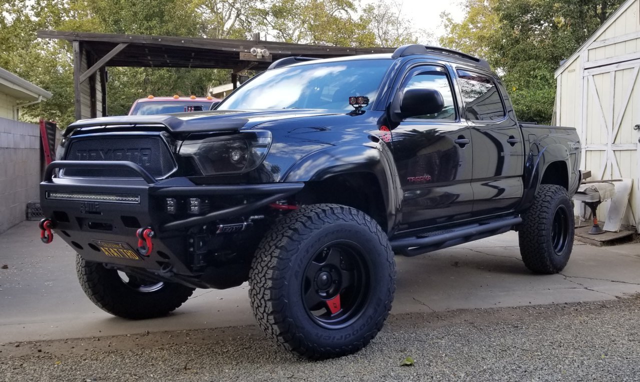

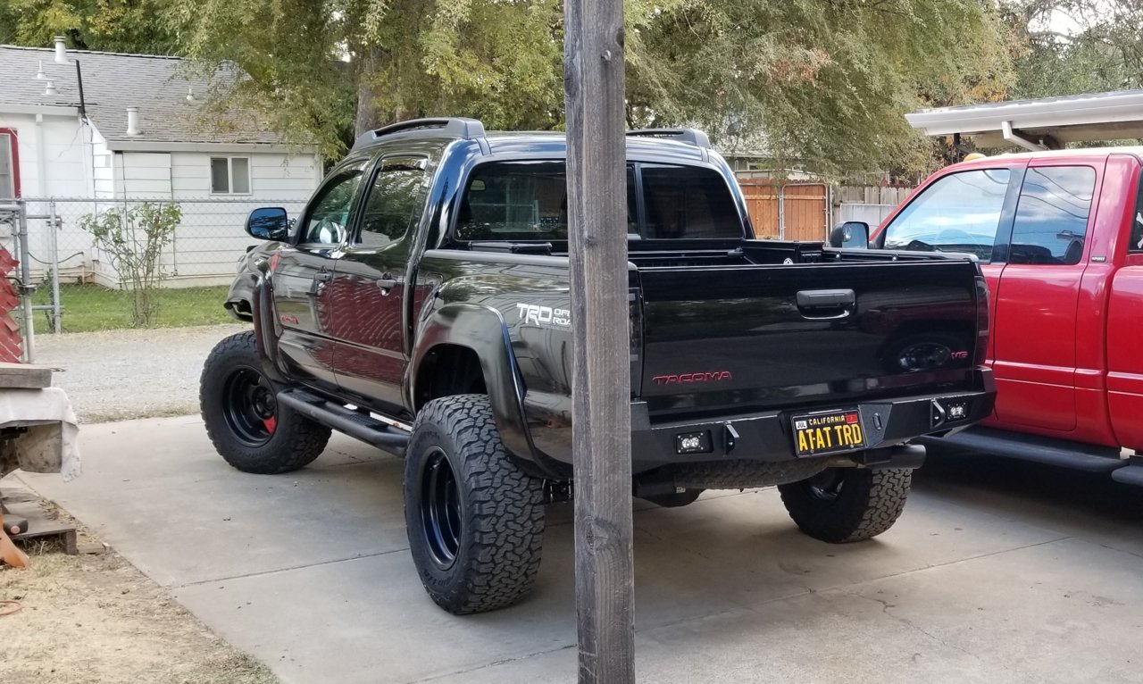

    I just got my 33's put on yesterday (285/70/17 Ko2) and it required more than I thought. The problem was my SCS rims. I got the F5's with the -38 offset and that extreme of an offset brought the wheel out, and put it right in the way of everything. I ended up needing to do a CMC and trim off a bunch of plastic because, with that offset, the rear of the wheel bumped right up against them at full lock. Also my 2.5in lift (already lowered to a 2in with the added weight of my BAMF offroad bumper and a 2nd battery) wasn't high enough, so I had to swap out the front springs on my Fox 2.5 RR's with 700lb springs, and then added some Dobinson's blocks under my 3-leaf AAL in the rear to level it out. I haven't measured it, but its probably now closer to a 4in lift.
    It looks sweet as hell but, if i were to do it over, I'd stay away from the huge offset wheels. Try to stay close to the factory backspacing and you should avoid most of the "exta" stuff I had to do, i.e. higher lift and CMC. Also, large offset wheels are apparently a bitch to balance, especially with off-road tires (first place I took it to straight gave up trying).
    TLDR: 33's w/ only a 2.5in lift is doable, but not with a large wheel offset.

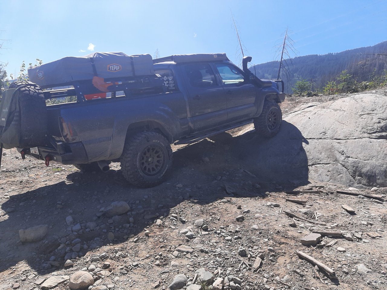

    DavesTaco68
    DavesTaco68 Well-Known Member
    Oct 22, 2016
    #200391
    3,349
    North Thompson, BC
    2013 Tacoma TRD
    - ICON UCAs, BP51/Kings, SCS wheels, 285s, Leer 100XR canopy. Greenlane aluminum winch bumper, Smittybilt X20 winch. Trying Falken AT3w now, Really like BF KO2s.
    I have the SCS Ray10 -10 17 inch, with 285 70 17 so not a true 33 inch tire. With a 2 inch lift it takes some work but it’s not bad.
    0 offset will make it a bit easier but -10 is no big deal.
    Having good aftermarket UCAs helps, and going to an Offroad shop that knows how to do wheel alignments definitely helps.

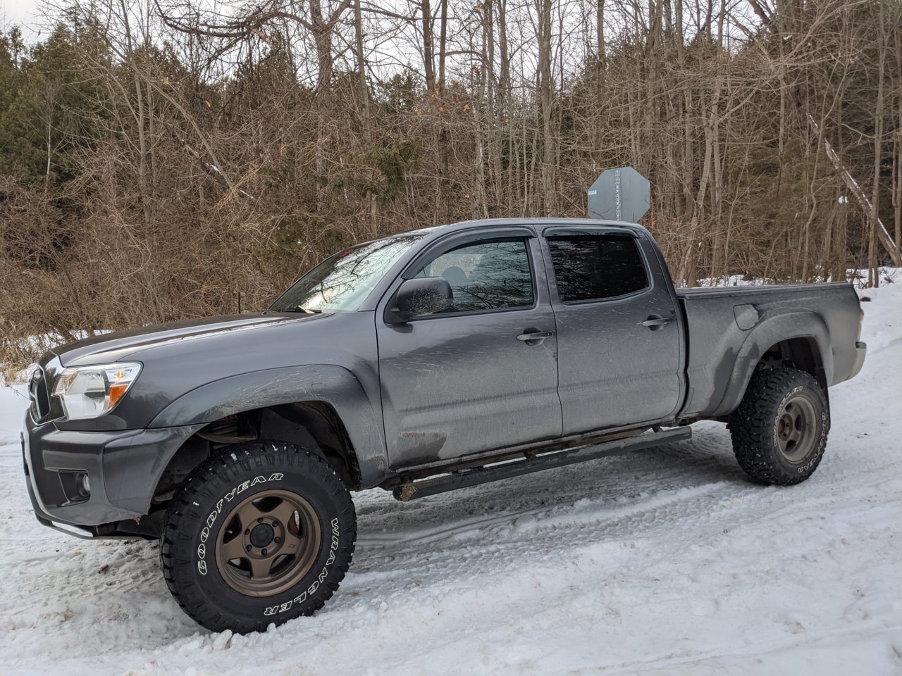

    #342914
    40
    2015 grey tacoma
    For reference my daily 265 75 r16 almost 32" tire. With about 1.5" lift. Front mud flap removal. -25 offsetPXL_20210101_181244503.jpg
    Edit: Alsohas front leveling kit installed

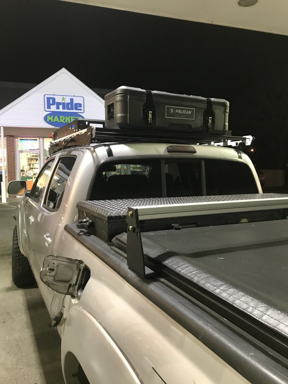

    Added some new goodies for my truck. Pelican case, Mobtown bed bars and victory universal rack on top of Uptop rack and just did cmc
