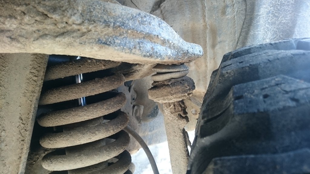

    No. Its simple to trim or bend the pinch weld. Only thing you gota worry about is if your tire hits uca. If it does then get rims with more spacing or just wheel spacers.

    What's the Uca?
  9. Oct 15, 2015 at 7:42 PM
    devinzz1
    devinzz1 Well-Known Member
    Jun 28, 2014
    #132892
    7,049
    devin
    lewisporte Newfoundland
    2023 aclb trd or mt
    icon stage 10 kit, toytec 1" bl, 35" general x3s, 17x9.5 procomp wheels, locker anytime mod, s&b intake, blackhawk 2.1 tune,
    Upper control arm.

    Stock wheels probably wont even fit with 33 12.50s. I had 285s(11" wide) on stock wheels and they rubbed the control

    33s will fit with no lift by doing the same pinch weld mod. Adding more lift wont gain clearance between tire and uca. 11.5 wide is about limit on stock wheels and even then they rub. Wheel spacers would be needed
