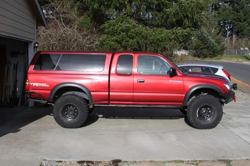

    Yes, you will need to lift it. Even then you'll probably have to do some clearancing of the front mudflap area.
    A 2.5-3" lift is pretty much the max for a 1st gen 4x4 without creating additional issues.
    edit: FWIW, I am running that size on a 15x8 wheel with about 2.75" of lift.
