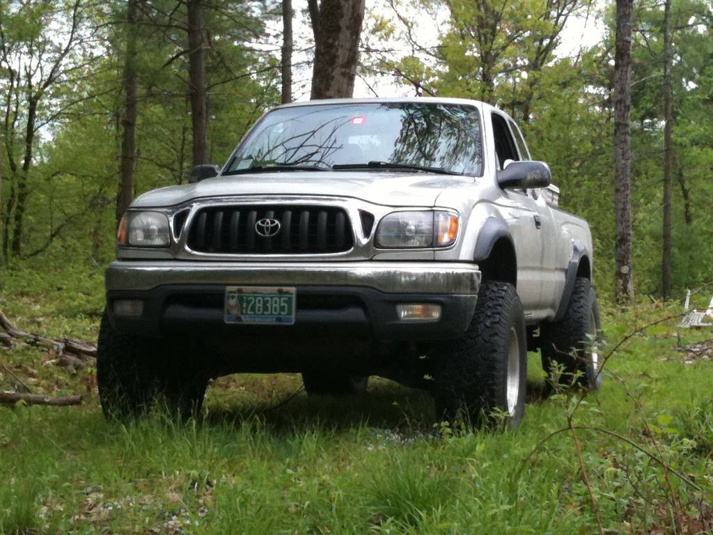

    33s will rub and will typically stick out. What rims will you be running? For 12.50s a 10" wide rim is advised. With the wider rim you will have more offset causing your wheels to stick out more. With 33s expect your mileage to drop 3-4+ mpg.
    What terrain will you be using them on? 12.50s are typically better on sand and mud while the 10.50s are typically better in other areas.
    I am running 33x12.50 BFG Ats with 10" wide rims. I am still triming as I adjust my suspension. When this picture was taken I had 5100s all around. Front set on top notch with stock coils. Rear Dakar 7 leaf pack.
