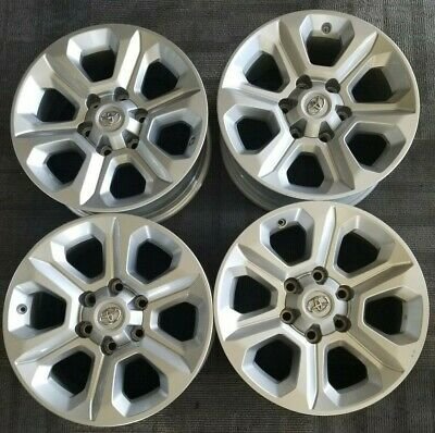

    The 4Runner SEMAS I have are +4 offset compared to the +25 on the OEM Sport wheels the truck came with, so they actually fit a bit better and don't hit the coil springs like the Sports did.

    Wait, I thought we were talking about 4Runner 17s?
    Yes they are 17x7. I'm currently running a 35x10.5 (~265 equivalent) without a problem. 285s are ~11.25" so I figured it wouldn't be an issue, but I guess at some point it has to max out.

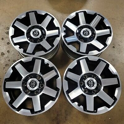

    4R TRD OR wheels are 7.5" wide

    40,279
    USA
    7" wide
    7.5" wide
    BudFriendguy likes this.

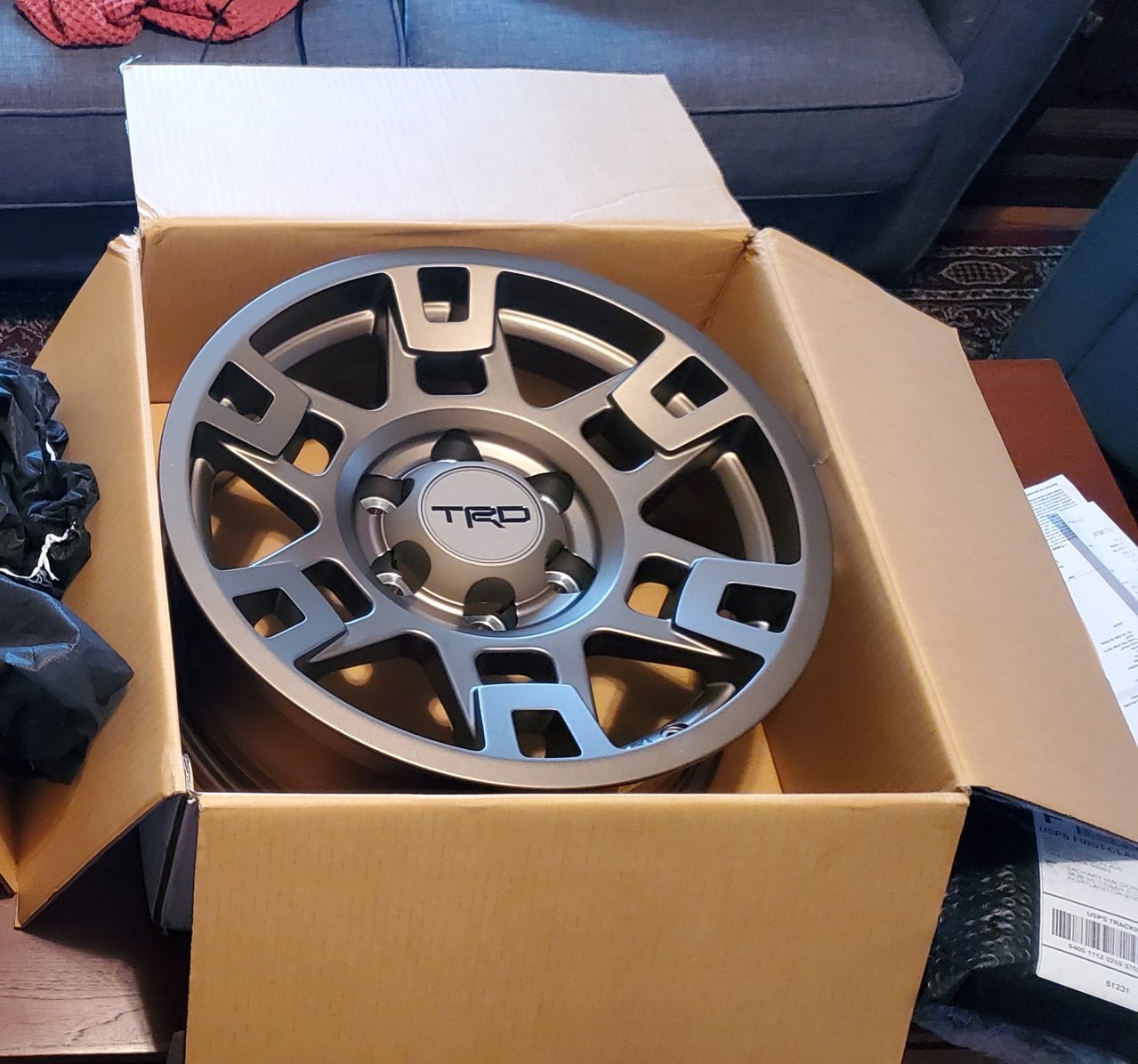

    Seriously why can’t Toyota just make an 8” wheel. That’s a good looking wheel. They make replicas that are 8” wide, you could sell those and get the reps unless your set on OE wheels.

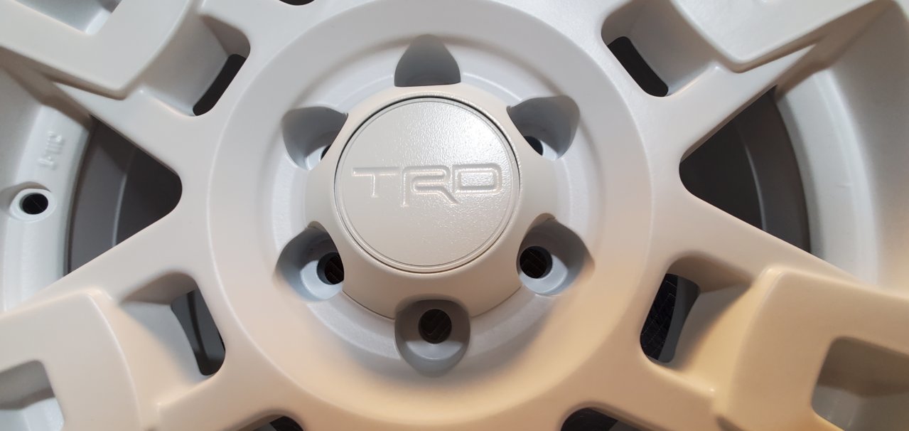

    Only due to spending ENTIRELY too much turning them white... :bananadead:
    But if push comes to shove, I'll bite the bullet.
