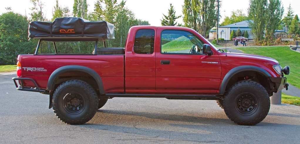

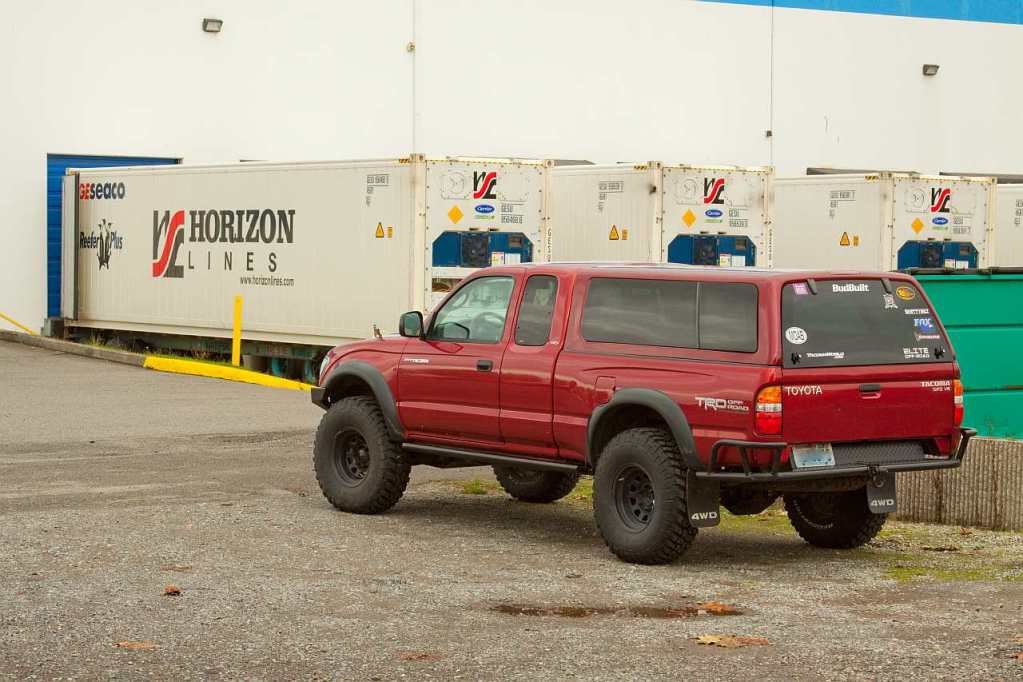

    portland Oregon
    2003 double cab 4x4
    elite bumper, xrc8 winch, 12in sub, cb, flowmaster, deck plate mod, 3in lift.
    Is that the factory roof rack on that truck because it looks clean!!!

    2002 Converted / 2017 OR
    Was a PreRunner, now it isn't
    yea it's factory.

    Wait what?

    Sick tacoma man! Looks really nice with those tires.

    Me too! :D

    Damn Mike! When'd you switch to 15's? Got any side shots?
    Did you have to crank the CO's?

    Haha! Not that long ago. Picked up some D windowed steelies that cleared my calipers. Did not have to crank up the COs, just pound on the pinch weld. :D
