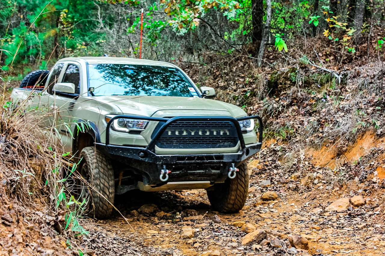

    It’s that time again, time to buy some new tread for the taco! I’m running 255/80/17 cooper st maxx at the moment. Setup has been great as far as performance and tread life, skinnies just aren’t cutting it for me on the trails I’m doing. I’m thinking about playing it safe again and going to a 285/75/17 and just trim back a bit more or nutting the fuck up and just go big with 315/75/16. Tire choice is going to be either st maxx again or stt pro. Not concerned with mpg, already average 15-16 daily. Only thing holding me back on going 35’s is all the weight I already have on my truck, steel bumpers front and rear, and full steel skids with the exception of the aluminum TRD skid. Thinking it may be a bit too much daily wise before I put my 4.88’s in, which won’t happen for at least another 3 months. Hence the reason I was thinking about still upgrading to a 34 but playing it safe without compromising the daily commute too much. What’s every one think? 0C511E0E-4D16-422D-B26C-4907B95B5DE7.jpgCDA55DFF-CAED-4540-9AA4-6912CC870E58.jpg ED2FC73B-7086-48FF-975E-FF8D78B40898.jpg

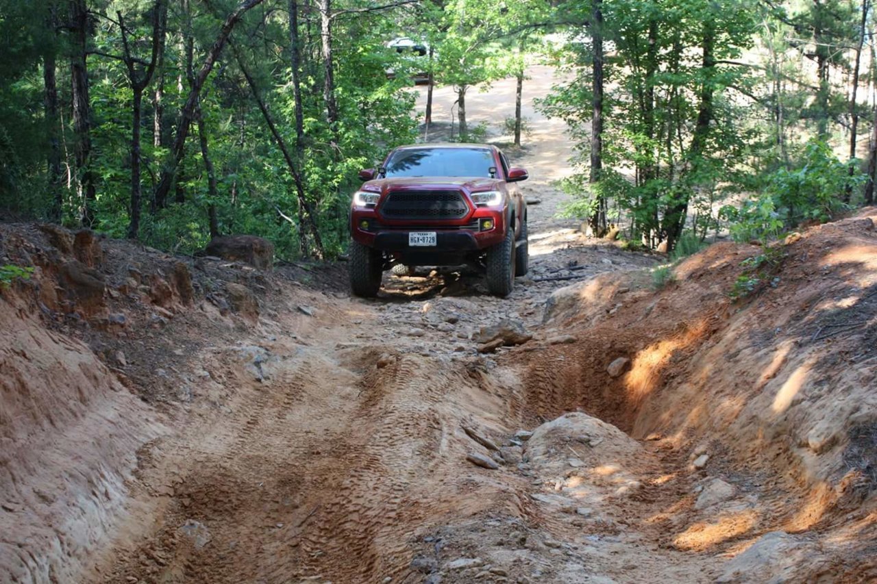

    Curious about the trails you are on requiring more than a 255, yet you say performance is great. ??
    Are you now running in sugar sand or something that a little more surface might help?

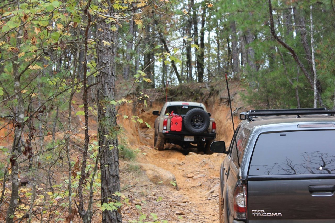

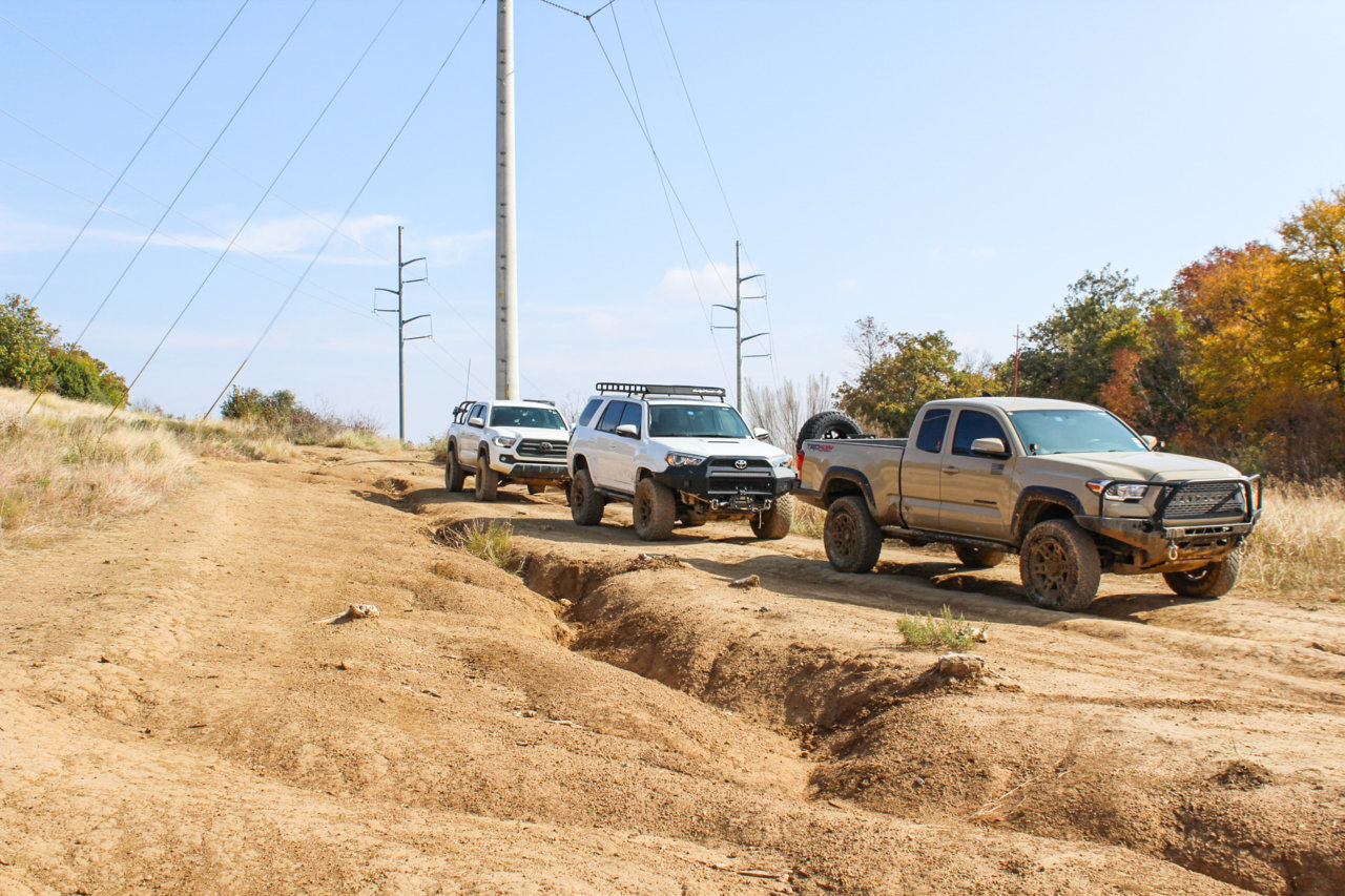

    I need more contact patch, mainly a lot of rocks down here in Texas. Skinnies do amazing just not exactly the tire I need for what I’m wheeling on. Not the best example of what I’m trying to show but you get the picture. 304DFB70-4299-4EB8-A7B7-8469878DD727.jpg

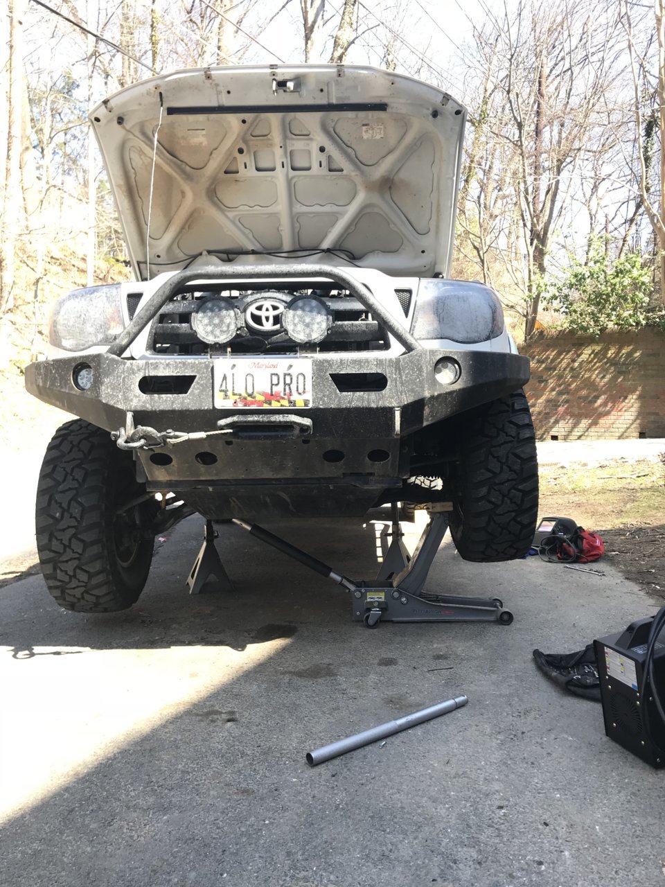

    Going from 255 to anything with width is fun. I just jumped from 255 to 295 and it’s amazing. Truck looks so much better.
    (Me clearancing for them)

    Thats Barnwell!

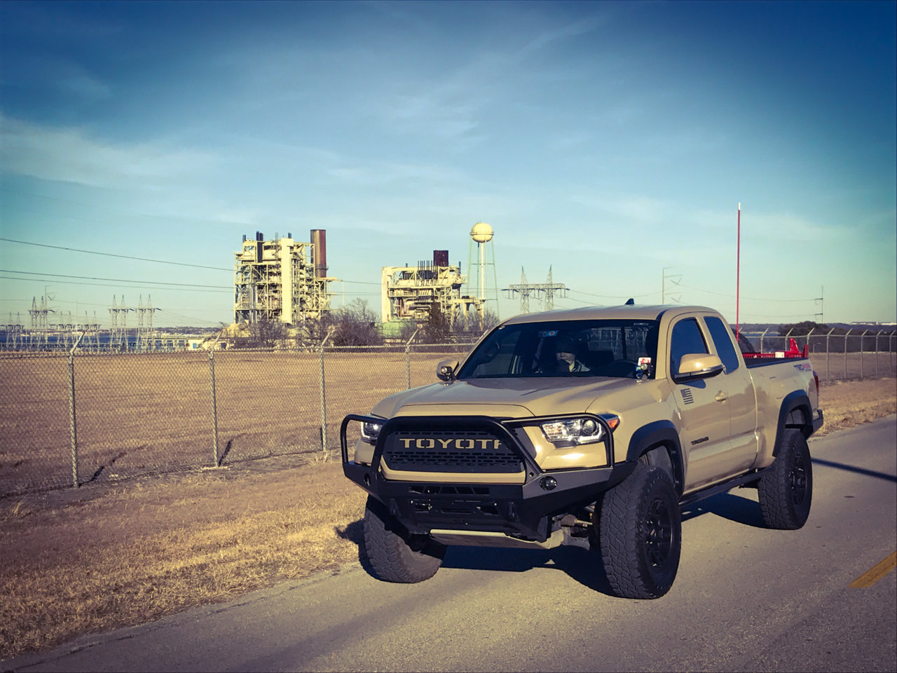

    what do you have for a lift on that?

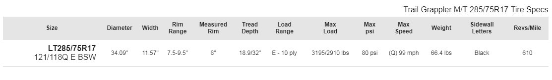

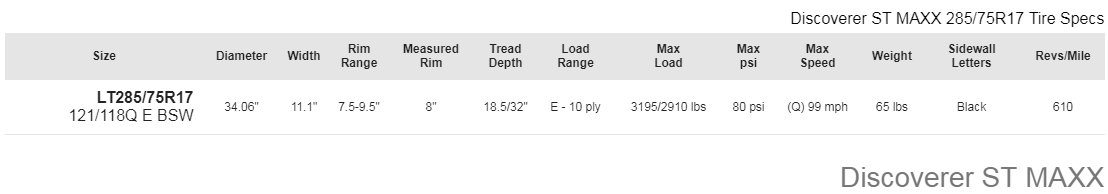

    Two that I would consider. They measure 34
    Cooper ST Maxx 285/75R17
    Nitto Trail Grappler 285/75R17

    Secondly, are you still on stock suspension? If so, you are not fitting 34's or 35's. Can't really tell but your pic in the OP looks like you are on stock shocks. You are gonna need UCA's also. Lot's of caster required to fit 35's

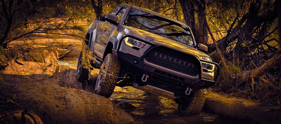

    Badass man, dam those looks great! Your on another level I’ve seen what all you have done to your truck great job. 35’s are my limit personally, but I know your SAS at some point so..:luvya:
    OME suspension all around, OME struts paired with 887 coils, SPC LR UCA’s, Cs097R Dakar leafs in the rear. Got a lot of cutting to do this weekend then. :sawzall:911FD32D-9423-4877-AE98-3E4F269C9E7F.jpg

    These are both solid choices! Dead set on the STT pros though. Think I’m going to do a 305/75/16...

    3” full OME suspension Front OME 90021 struts paired with 887 coils, SPC LR UCA’s, Rear nitrocharger shocks with Cs097R heavy Dakar leafs overload left on. Nothing fancy gets the job done and takes a hell of a beating. Plan on upgrading to a decent mid travel setup in a couple years probably. Mid travel is probably as crazy as I’ll go for what I do with mine.
