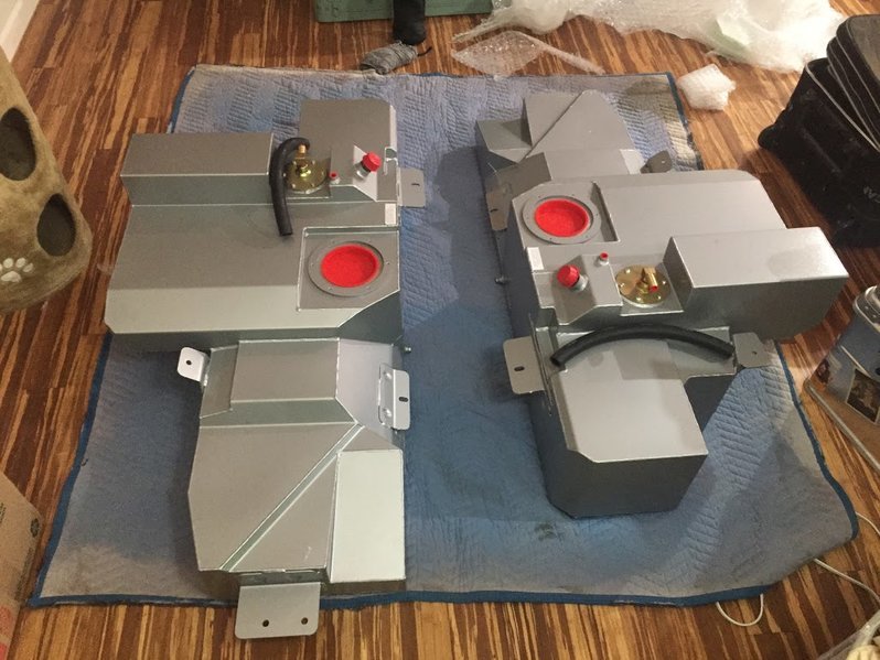

    boom, they look so nice lol

    Very nice. Too bad shipping on those bad boys is so high. It would be cool if the Austrailian company would sell a franchise, along with specs, to a US fabrication company. After all, it's not rocket science. It's just a whole bunch of steel plates welded together.

    Very nice. Those things look bulletproof. Would you mind shooting one a couple times and posting pics?:devil:
