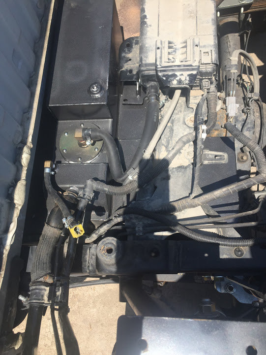

    so got the bed off and did find the charcoal vent was kinked. I dont see how you can do this line with out taking the bed off.
    as you can see in this pic, it looked fine from under, but once i got the bed off you can see how kinked it is. I think this is what was causing the issues with filling. will see how it fills once i go though this tank.

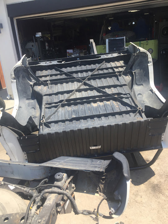

    if i were to install this again, i think i would take the bed off also to ease install.
    also, be careful removing your bed, you dont want this to happen lol

    That does look easier. I usually get some dumb friends to help with bed removal:rofl:

    yea all my friends were out of town so had the wife help using the engine lift, shit just went sideways once it was in the air 5ft lol weird part was that there was no damage at all to the bed, so thats nice
