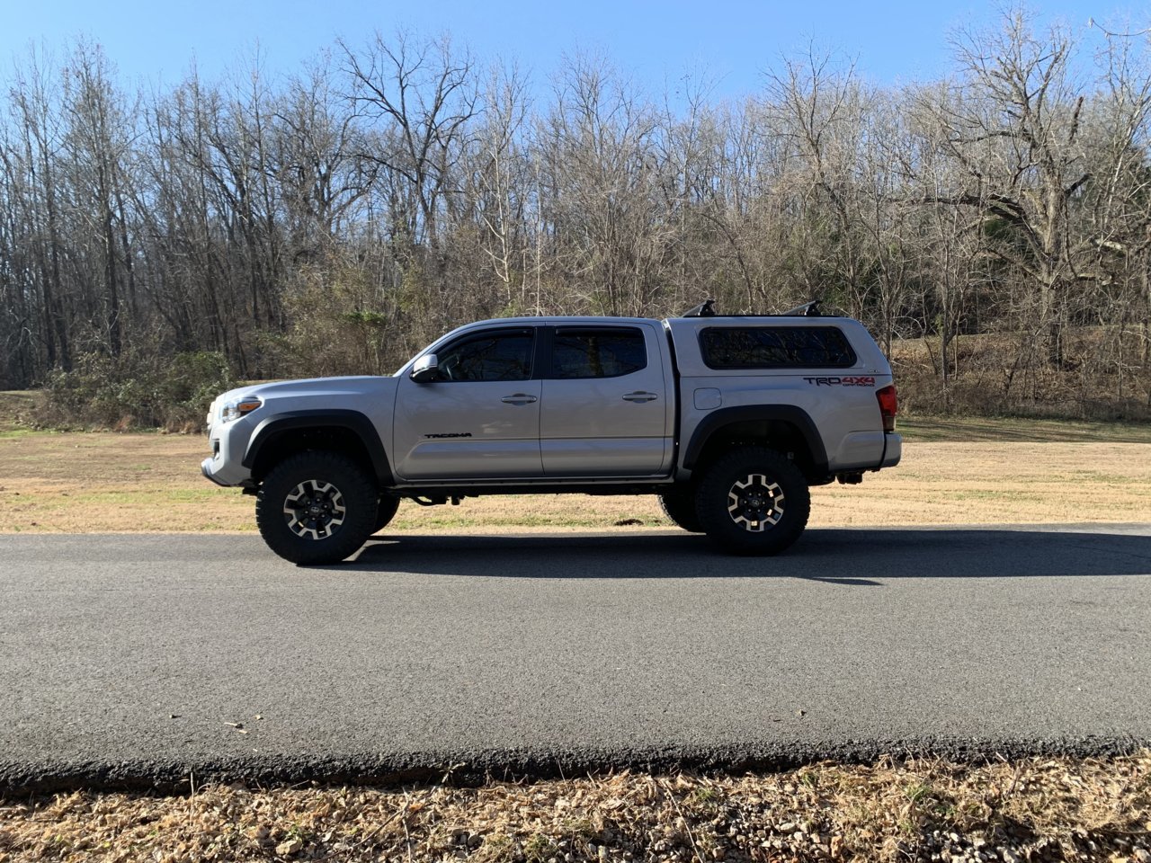

    2019 Silver Tacoma DCSB TRD OR
    They ran really well stock. I bet that thing was a screamer with cams, headers and a tune!

    2019 Tacoma off road 4x4
    Your truck looks good what setup do you have?
    BCfiremedic[QUOTED] likes this.
    Thanks! I have the Bilstein 5100’s and OME 888 coils with Freedom Offroad UCA’s up front. Heavy duty Dakars and extended length 5100’s(I think) in the rear. I’ve been happy with it so far. I have a little over 6,000 miles on the set up.

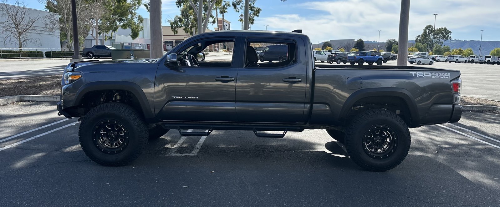

    2021 Magnetic Tacoma TRD Off Road 4x4 Long Bed
    2021 Toyota Tacoma TRD off road
    With 275/80 r17 MilestarPATAGONIA X/T
    34 x 10.5 x 17

    Tune, 285/75/16, Diode Dynamics, PPF, Bakflip Mx4, Meso, Cali Raised, TJM
    34x10.5x17 would fit better than 285x75x17 but still going to take some massaging for it to fit properly.
