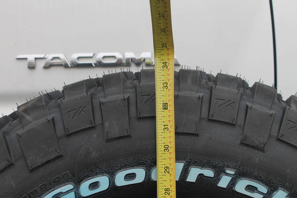

    Thems km2's. They should be 33.9. Don't bfg run a little small?

    Most tire companies round up. Pitbull seems to be the exception.
    Also, height and width change depending on wheel size, air pressure, treadwear, and weight of vehicle. Manufacturer specs only mean so much.

    Ok, here are some full truck shots, Sorry about the white truck in the white snow in the white flat light, lacking a bit of detail. Also to follow are the detail shots of the tire vs openings as they are now.
    Does not hit the body mount at stock ride height in current configuration. Have not flexed out, but does not height pinch weld at stock ride height. Does not hit upper control are at stock ride height.

    yeah thats because theyre two inches skinnier than the 285/75's

    Weight of truck is not on tire. Measure them on the truck and I guarantee you lose .5in or more height.

    True. Oh well. If the tire is 1 inch shorter it only makes a 1/2 inch difference in the height of the truck/axle. I can live with that.
