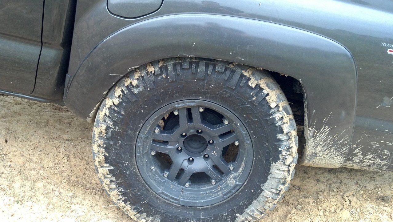

  15. May 22, 2013 at 7:05 PM
    #55
    Limitless
    Limitless [OP] Well-Known Member
    Dec 7, 2012
    #92631
    139
    Scott
    NW Illinois
    12 DCLB White TRD
    De-badged, Tinted Windows.
    The BFG's KM2 that I am running is 33.9 OAD.
    Here are some pics from the a week ago. Please note, more grinding, pounding and cutting was done after these pics.
    -The lower portion of the pinch weld was ground flat.
    -The Cab mount went back another 1/4" - 3/8"
    -And the Sledge Hammer came out for good measure.
    I will post the finished, well almost finished, shots up when I get a chance.

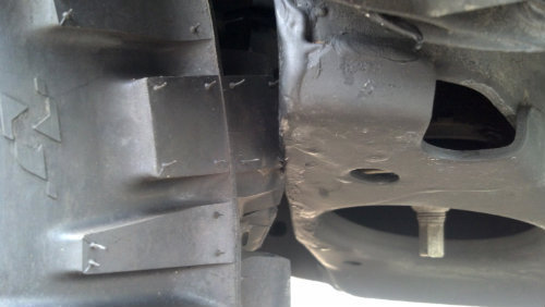

  16. May 22, 2013 at 7:09 PM
    #56
    Limitless
    Dec 7, 2012
    #92631
    139
    Scott
    NW Illinois
    12 DCLB White TRD
    Here is a descriptive pick of the further cutting, beating and grinding that followed:
  17. May 23, 2013 at 8:08 AM
    #57
    Gearheadesw
    Gearheadesw Well-Known Member
    Apr 2, 2012
    #76139
    3,139
    Davenport Fl
    2016 GMC 2500hd
    some
    I was able to beat my pinch weld almost flat, why cut? Am I missing something I should be noticing?
