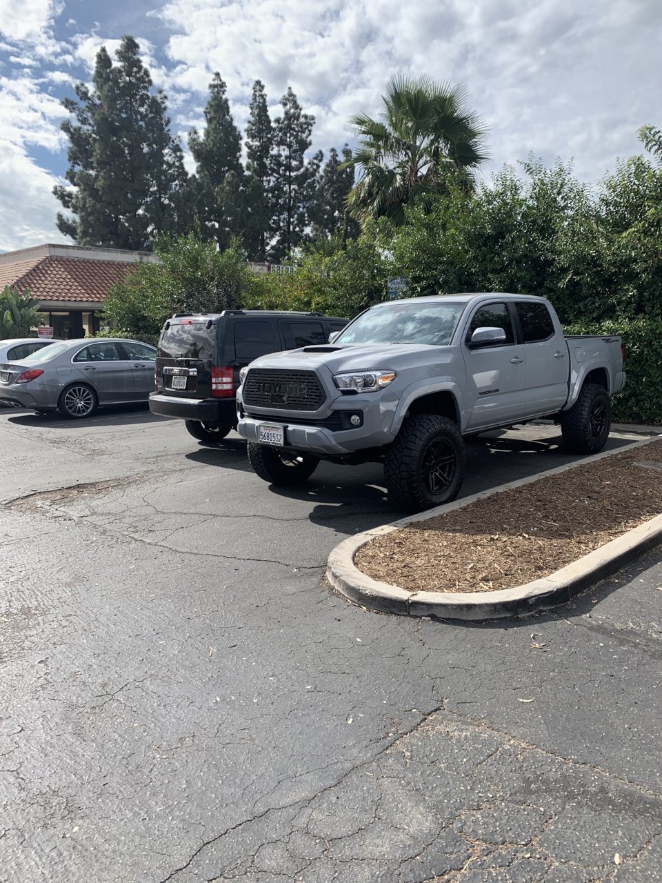

    ( photo of my truck down below )
    Facts: I’m on a 4 inch Maxtrac lift with Bilsteins all around. I currently am riding with 295/70/17 Nitto Ridge Grapplers. Everyone said I’d rub and it wasn’t possible.
    I don’t.
    98% of the time.
    The smallest trimming was required in front left fender to not rub in reverse turning the wheel right at full turn.
    I want to make the leap to 305/70/17.
    I’ve called my shop. They said with some heavy heavy BMC, we can do it. BUT they can’t promise I won’t rub. Which is fine. I completely understand.
    my question is... does anyone have experience with this 2WD setup ? Do you rub ? Is this possible ? Just using the truck for daily driving and nothing more.

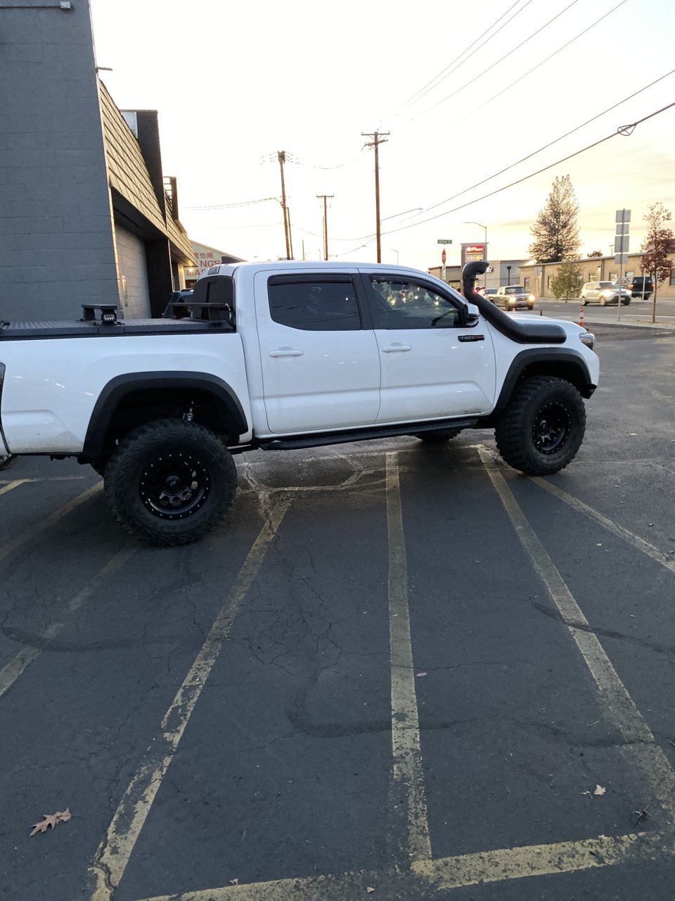

    I'm on 35's with 3" lift CMC, pinch weld and 4.3+ caster If you go with the right size rim with the correct back spacing and offset your good to go . AOHD8378.jpg

    BTW the tire size your asking about converts to a 34" tire not 35"

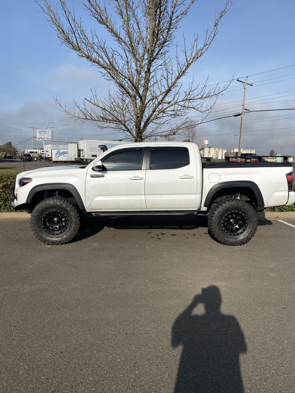

    front kings are at 2.5-3" running 700lbs coils Truck is heavy with armor/ winch, Tent, Solar Shower, Rack and Diamond back se . The rear has OME EL096R plus a 1" steel block for a total just over 3" Also has a 3degree steel shim. Truck is about to have a Mobtown high clearance rear with single swing out. When it gets here I'm at 16 weeks now LOL IMG_2669.jpg Kings where not on in this pic.
