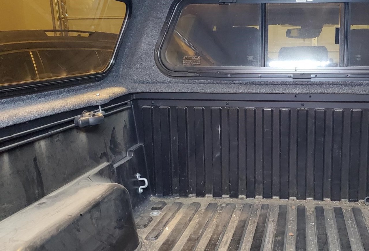

    Dawelda
    Dawelda Well-Known Member
    May 9, 2021
    #365171
    633
    West of West Phoenix
    20 Tacoma DCLB TRDOR Desert Sand
    2.5" lift w/33" tires, 10K Winch & bumper, camper shell
    Looking at Wilco (thanks BTW) and I don't understand...they say "...spare tire directly to the cab mounted bedrail on your Toyota Tacoma"
    and again they say "Factory cab mounted bed rail is required and is not Included."
    I don't know what "cab mounted bed rail" is? I'm including a pic of my bed so, are they insisting upon another of the rails I have installed along the sides? Do I need one of those at the cab end?

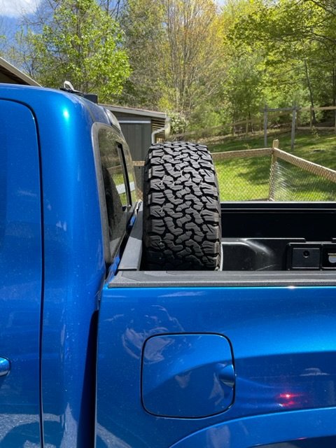

    This certainly isn’t perfect, but a good temp solution I’ve used while laying the tire down flat.

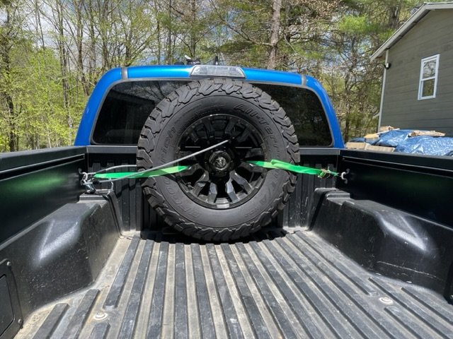

    wolfpack65
    wolfpack65 New Member
    Jul 27, 2020
    #335811
    4
    Sorry, mine are 33’s.
    Well, this is what I’ve done with my spare. Used a ratchet strap to secure it on the cab side. Cable lock to keep a$$holes from possibly stealing. ‍♀️
    Kinda now looking for a cover to put over the spare to keep sun damage to a minimal. Thinking I’ll either have to adjust how I’ve mounted it and/or cut a slit in a cover to feed the strap through….

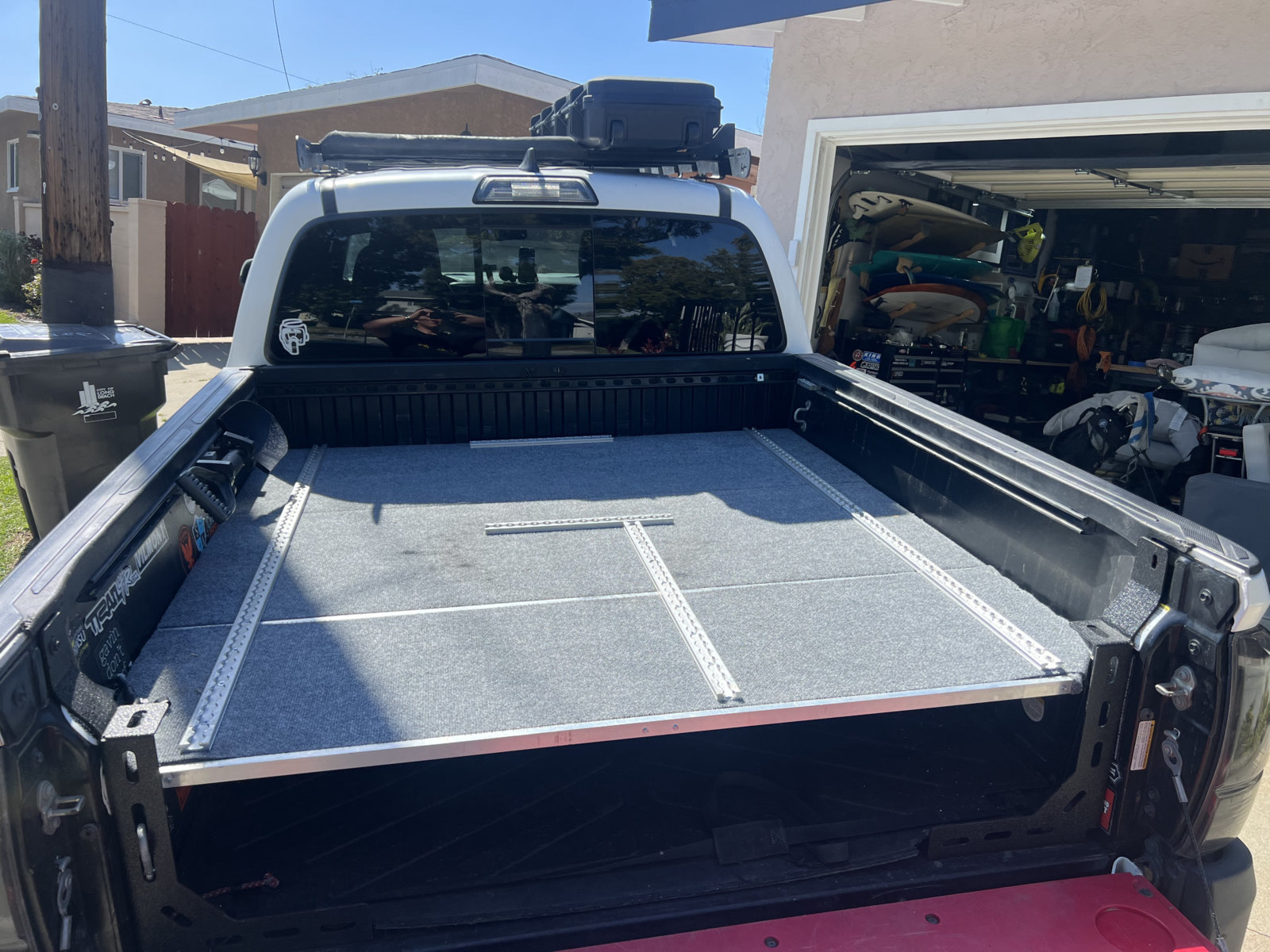

  18. Oct 21, 2023 at 1:33 PM
    #138
    GoldenTaco27
    GoldenTaco27 Well-Known Member
    Aug 29, 2015
    #162919
    462
    Blake
    Long Beach Ca
    2017 Tacoma DCSB TRD Off Road
    @hungoverland on IG, King 2.5" EXT Travel w/ Archive Garage shock relocation, Icon RXT leafpack, 285 Nitto M/T's, bronze Raceline Defender wheels, TJM front/rear bumpers, TJM Sliders, Prinsu Cabrac, Katzkin leather, RSI Smartcap EVO topper, OV Tuned, MESO everything, Spyder headlights and tail lights, center mounted infant restraining system (CMIRS) \m/
    Really leaning towards a bed rail mounted solution for my 35” spare after reading all the input in here. I had a swing out on order with Outgear Solutions that looked as clean of an option as any, but I really prefer the look of the non-swing out version.
    With that said, this causes an issue with my basic platform in the bed of the truck. The platform is similar to Bam Bed’s style with 3 piece design that just utilizes the factory bed liner edges. I will have to cut and box out the area where the tire will be on the passenger side. I liked the simplicity of just the three boards, but I can’t think of a better solution.
    Anyone in here running a spare with a platform? Anyone have a better solution that doesn’t involve a swing out or strapping it to the roof rack?

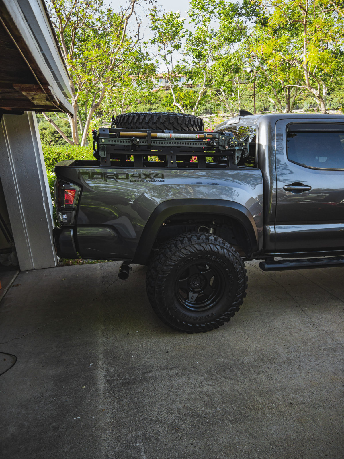

    LordJuicifer
    LordJuicifer Active Member
    Oct 24, 2019
    #308936
    25
    2015 MGM Sport
    I ended up just slapping a front runner low profile rack inside of my larger RCI bed rack and trimming the center beam on the RCI rack to allow the tire to poke through. I used a strap from dirtking to secure the tire to the front runner
