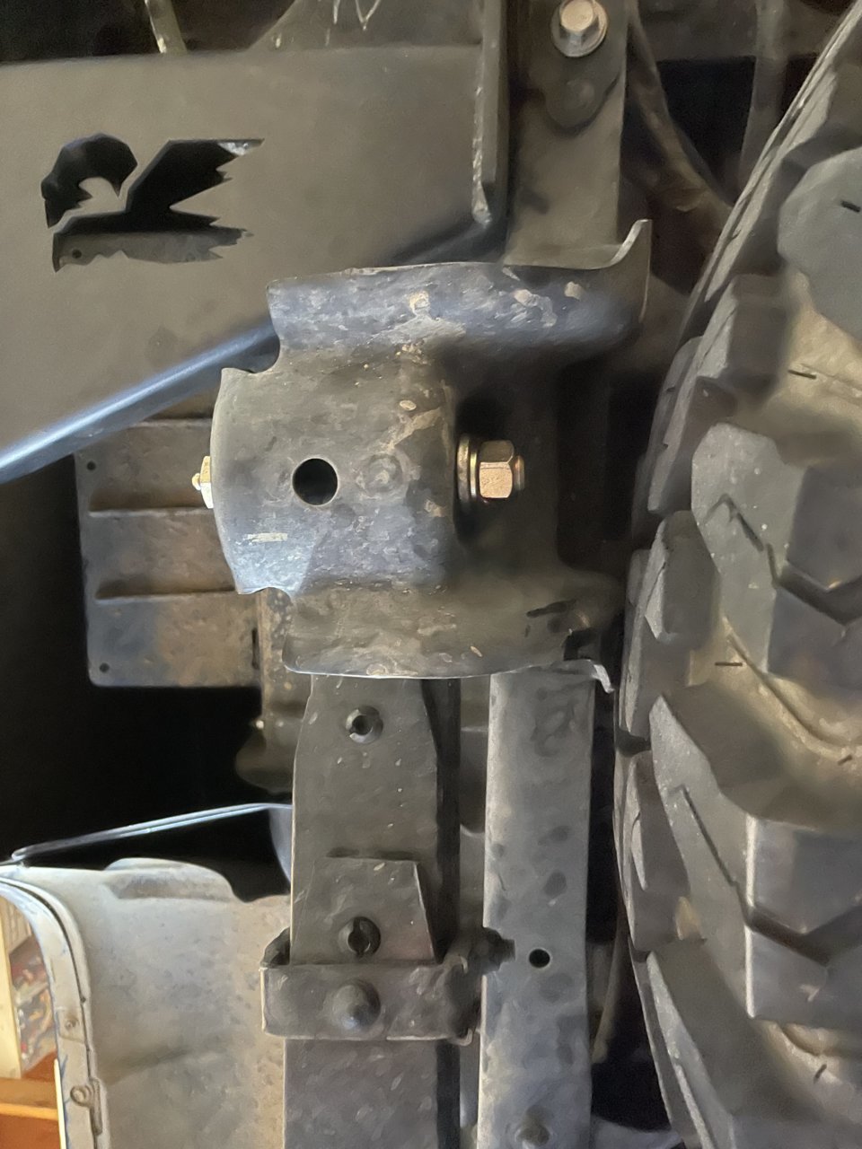

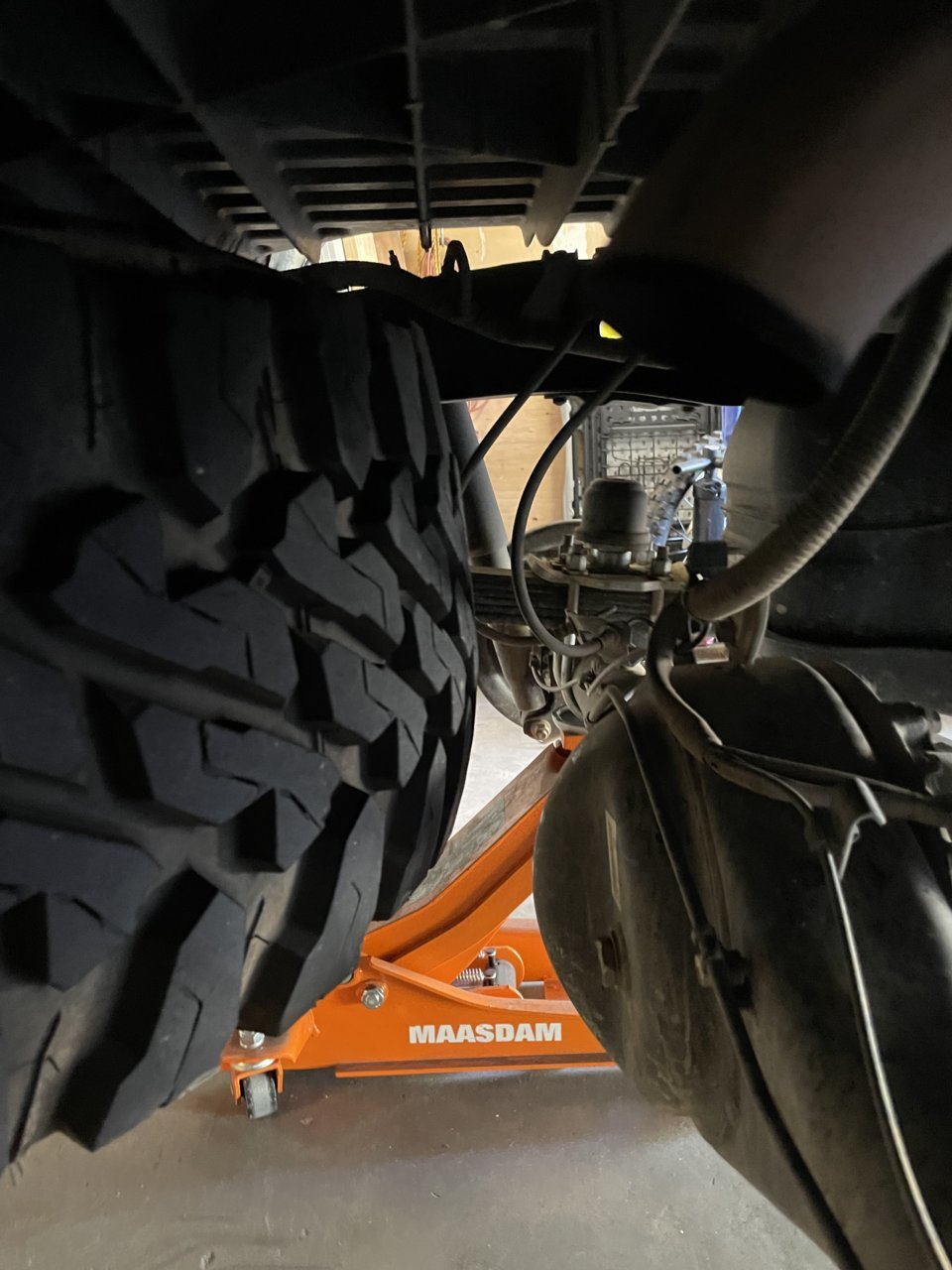

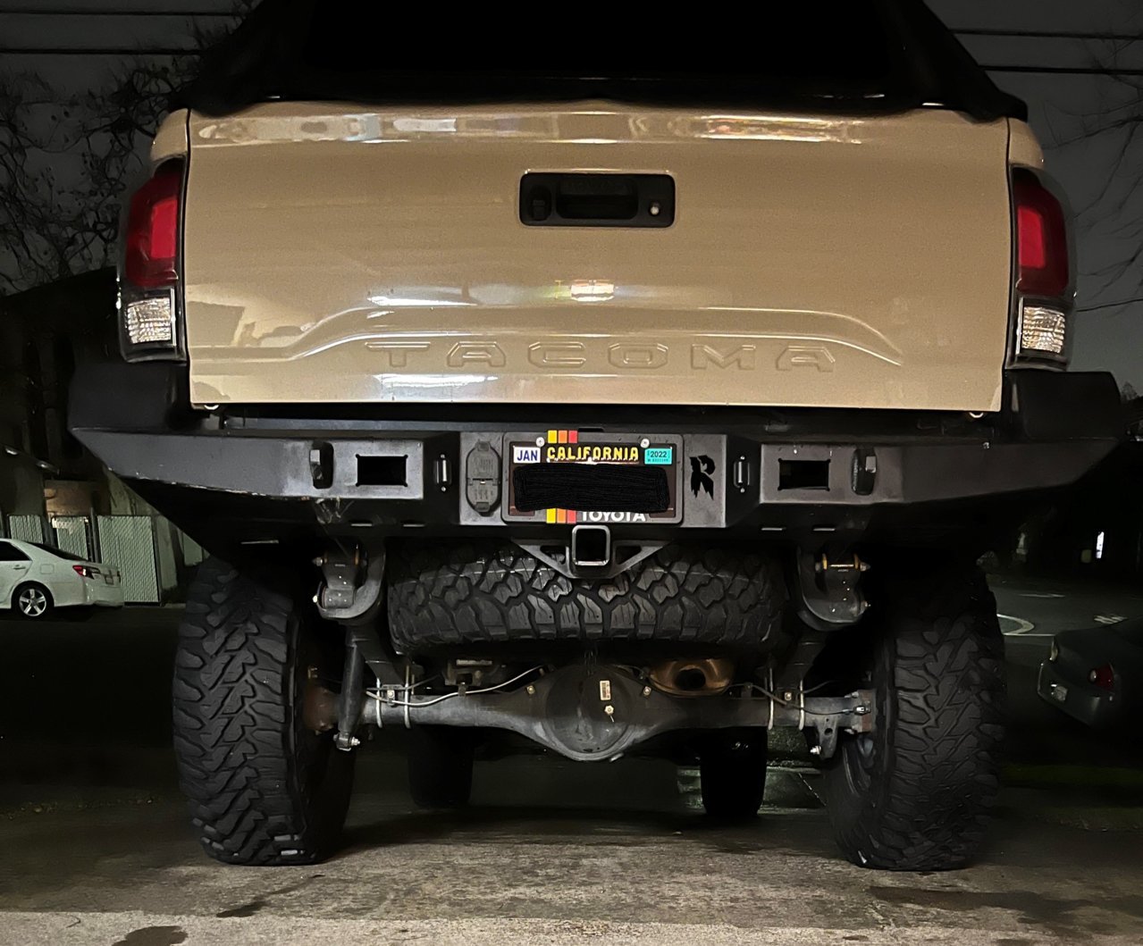

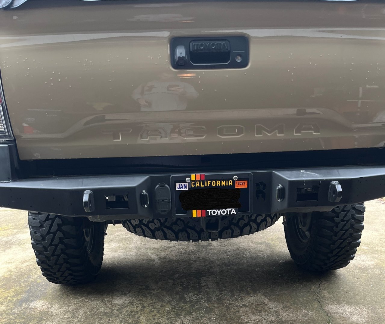

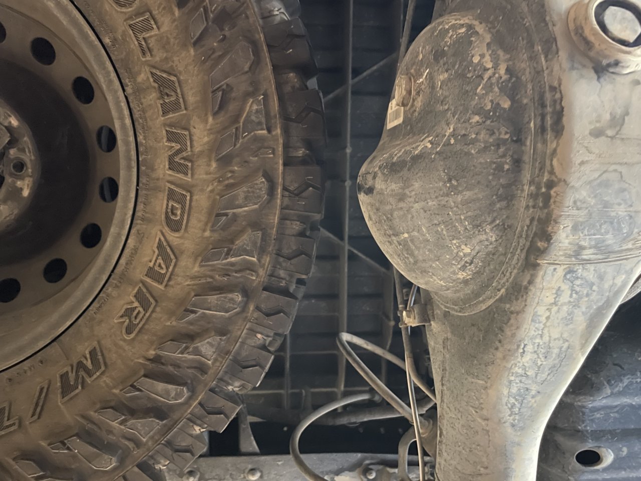

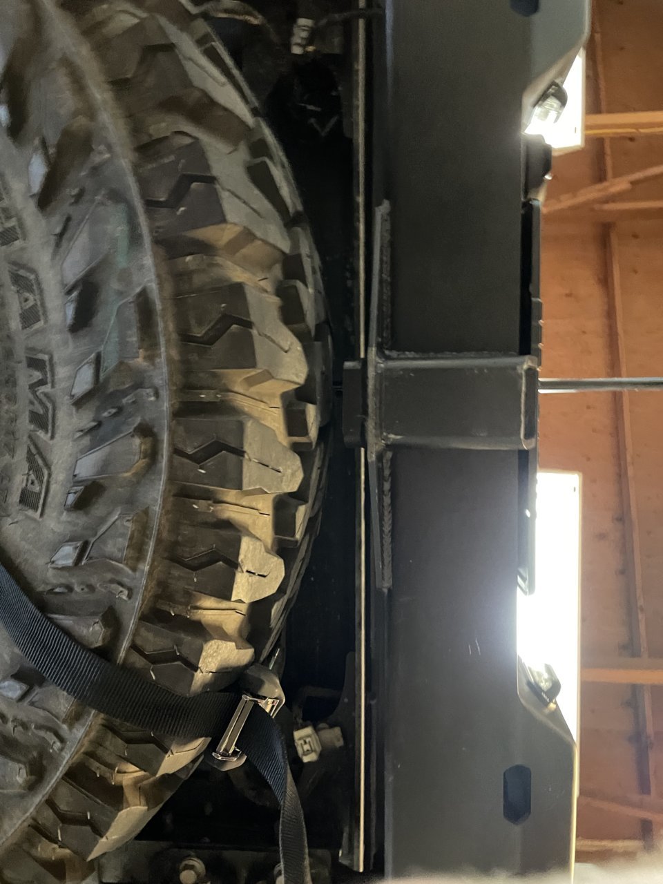

    I'm sure this has been done before but I'm pretty stoked I made it happen. It took a lot of modification and my new high clearance bumper was the last piece of the puzzle. The factory bumper trailer hitch receiver pushed the tire into the diff.
    Another user on here posted a thread, I can't remember who, where he moved the spare tire chain bracket by drilling two holes and moving it back toward the tail gate. I copied his idea and also hammered down the tire guides. I also chopped my exhaust back a bit. And finally the tire needs to be deflated to fit in between the leaf spring hangers snug.

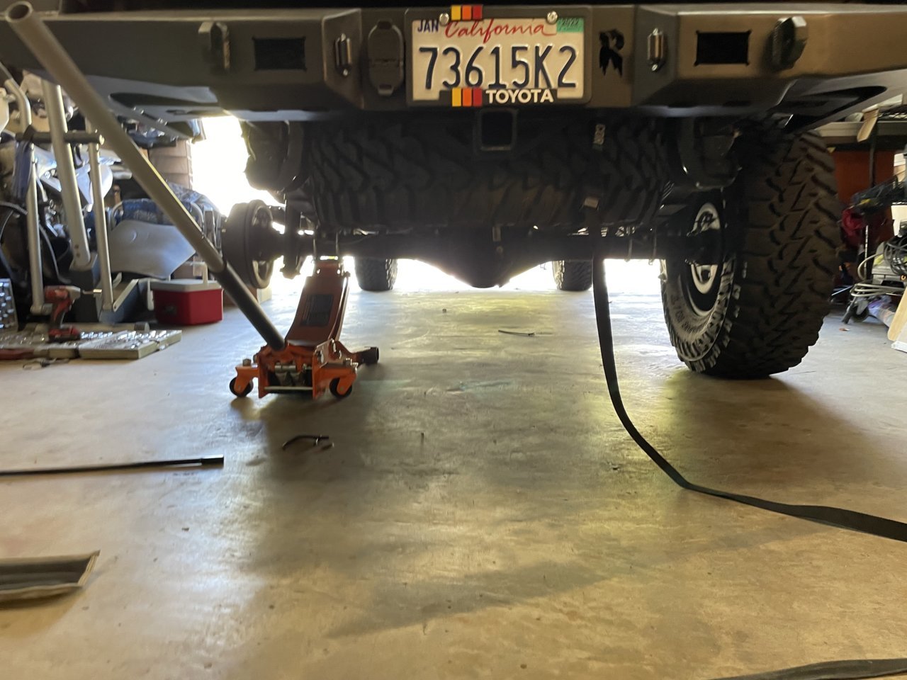

    I know this definitely is not for everyone, but it's gonna work nice for me. I have a portable air compressor that allows me to keep it flat. I used a strap to help pull the tire back as far as possible while lifting it into place.

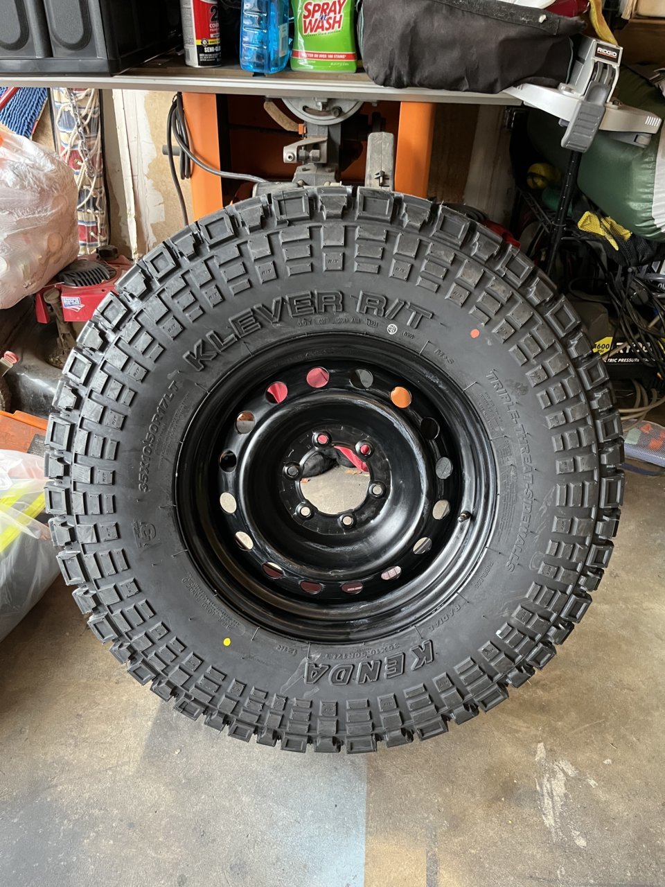

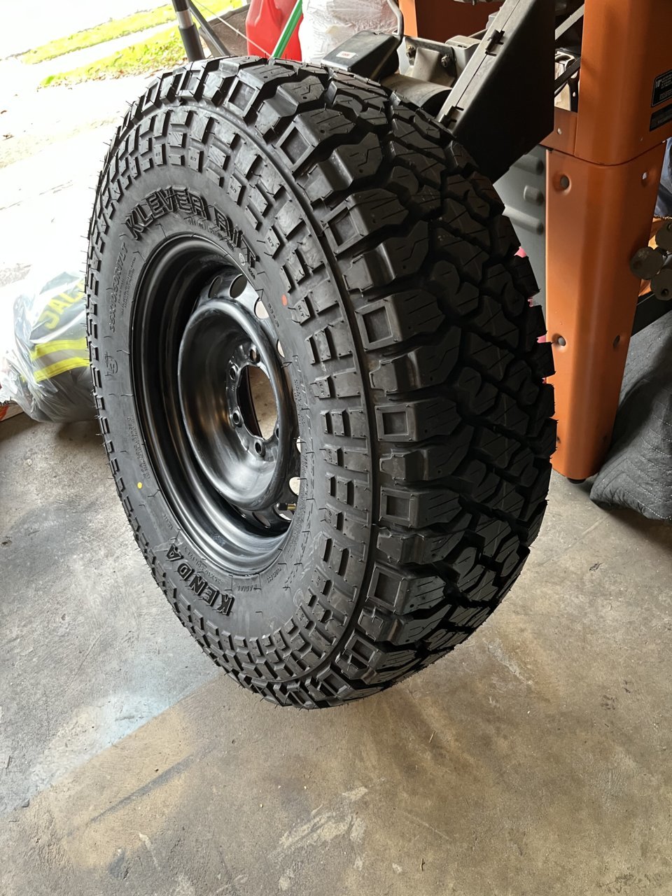

    My truck is lifted with Dobinson's leaf's so I have some more ground clearance for such a big tire back there. and finally I test fitted my 35x12.5 geolandar's to see if it could be done, but I plan on ordering a Kenda Klever RT in the 35x10.5 so it fits just a bit higher up in the undercarriage. It should be fine since it's only going to be a spare and not worked into my tire rotations.
    Right now the exhaust tip is about 5-6 inches away from the tire which worries me a little. I plan to remedy that by just making a turndown elbow right at the catalytic converter.
    Anyways thanks for reading and here's the test pics.

    Ya all the points you made are why I wanted to try and keep it in the factory location. I also have dirtbikes and wanted to be able to run with the tail gate down so a swingout was out of the picture.
    So far its working out pretty good and I'm happy with it. I'm running a 35x10.5 up there just to keep it tucked up a little higher and since it's only going to ever be used as a spare. Like I said it works for me but obviously there were a lot of steps involved to make it actually work. And the tire has no air in it otherwise it wouldn't fit, but I have an air compressor under the hood.
    As far as the relentless fab bumper goes I love it! It was a bear to install though and I ended up having to mount it and un mount it 3 times before I finally cut enough off the bedsides. It's a solid and awesome bumper, I think the only gripe I have is that they didn't put the receiver hitch behind the license plate instead of letting it hang down low like they did. But it's not a deal breaker.
