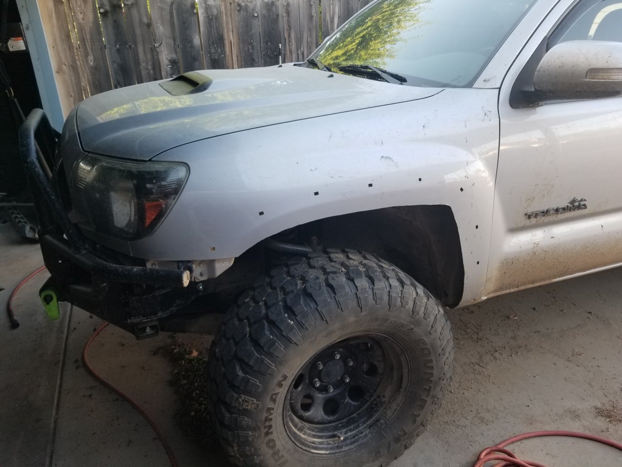

    2.5" lift w/35's
    I'm running 35s on about a 2.5 inch lift. Takes a lot of cutting lol
