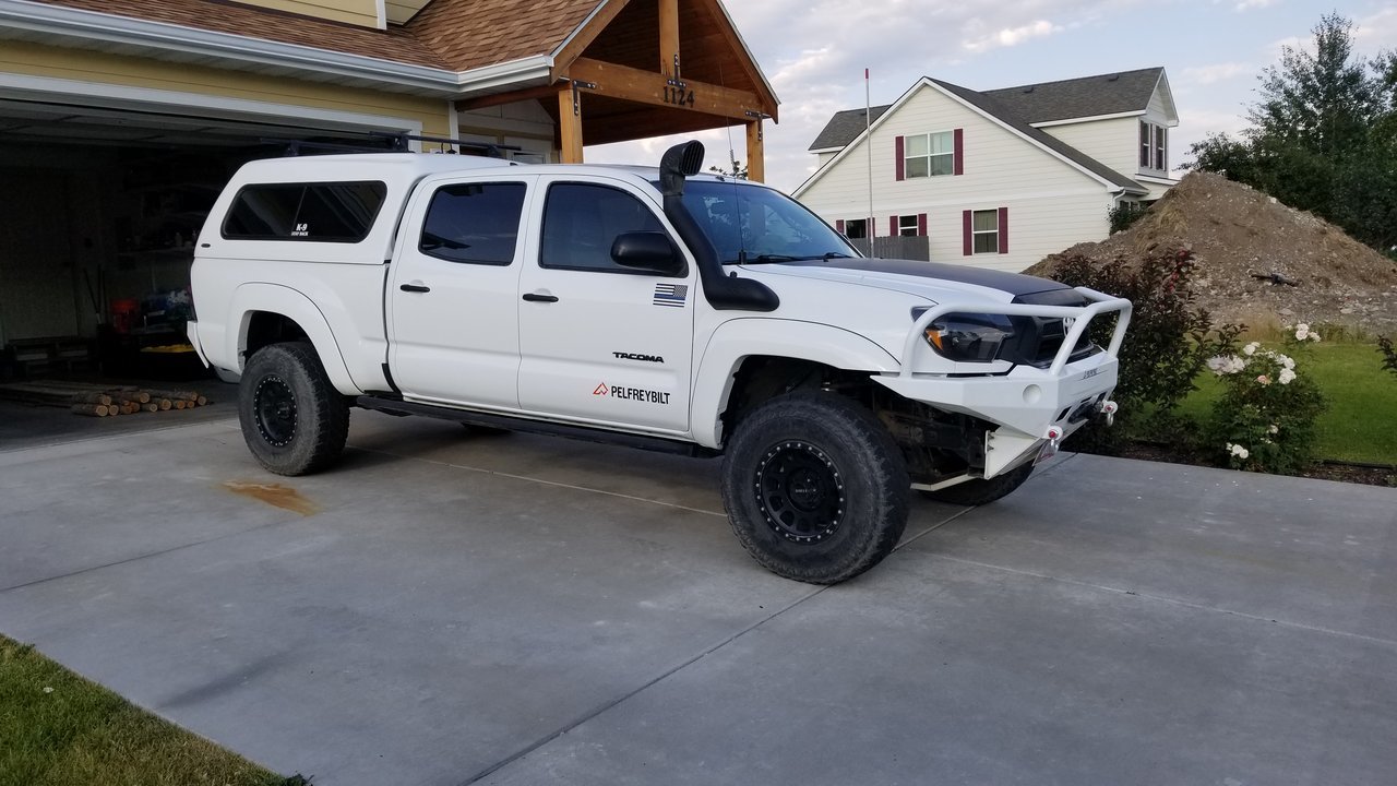

    Looking for anyone here on T-Dubb who specifically runs 35" (315/75/16) on 16" Method NV rims.
    My 33" ST Maxx are at about 50% read after just over a year and I'm considering 35s next go around. Just wondering if anyone with my rims can give me their personal feedback on the backspacing and rubbing issues.
    Obviously a CMC and fender cutting is required.
