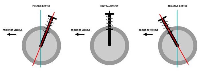

    Moving the lower control arm forward would increase caster. Moving the upper control arm forward would decrease caster.

    Like this:

    correct, so building both a top and bottom that moves the pivot point forward the same amount will allow you to keep the caster, but i am betting i would run into other issues.
