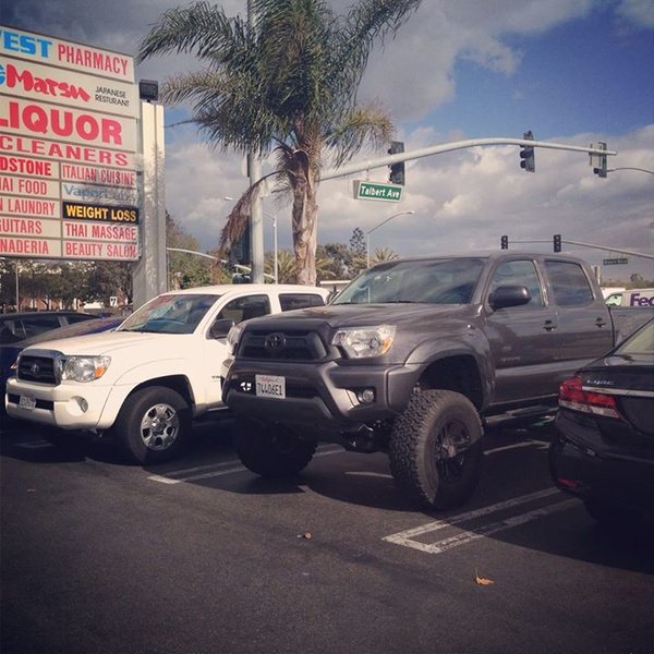

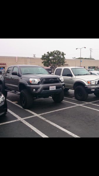

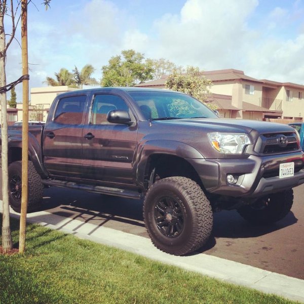

    Do you have any current pics of your set up now? Currently you are running 33's on a 6" lift correct?
  17. Apr 7, 2014 at 9:29 AM
    #17
    Cwarner272
    Cwarner272 [OP] Active Member
    Jun 9, 2013
    #105908
    29
    Casey
    Huntington Beach, CA
    2012 tacoma trd off road 4x4
    @project_relentless 2012 Tacoma TRD Offroad 6" Rough Country suspension lift 315/75 Toyo Open Country M/T 16" MB wheels 1.25" wheel spacers Westin Pro Traxx steps Plasti-Dip badges, bumper, and grille Pioneer touch screen stereo 1500 watt amp 12" subwoofer Flowmasters 2.5" exhaust Snugtop camper shell Custom built headlights: DDM tuning projectors LED concepts colormorph halos Black headlight mod
    That's correct. Here's some pics

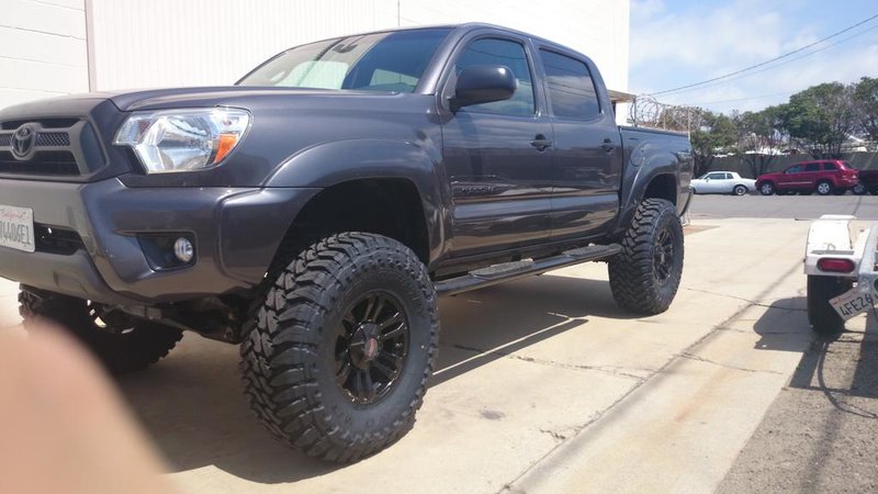

    Got my tires on 315/75/16 had to do some serious cutting and cab mount chop, but I think I'm good now

    Thanks man truck looks great
