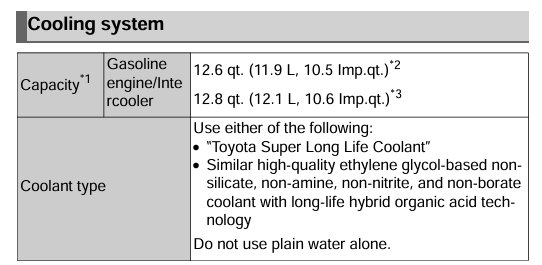

    Can confirm that it is intercooled from the 4th gen owners manual, looks like it's water-to-air as well given the coolant capacity specs. Pretty excited about it not being air to air like so many other systems. Of course this can still heat soak, but 4th gen owners can expect far lower average IAT's.
