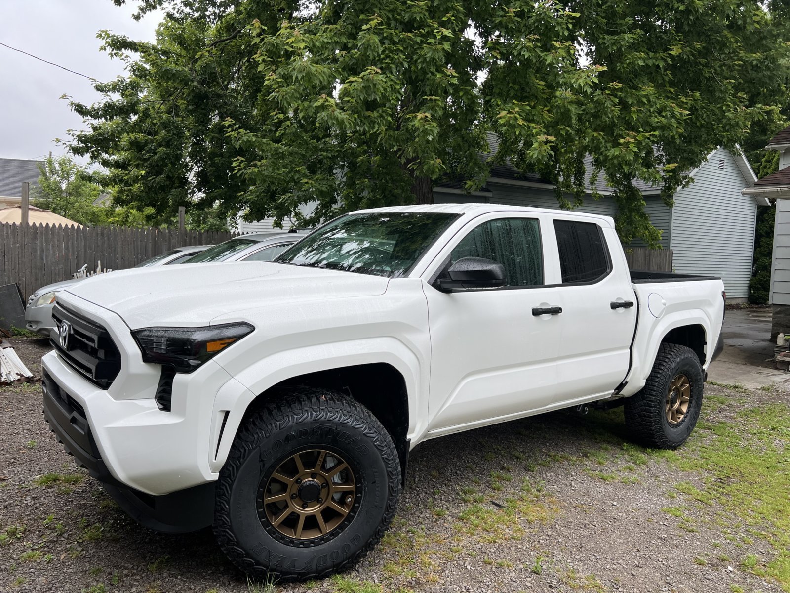

    315 70 r17 on 17x8.5” foxtrot wheels +35 offset. Zero modifications on an SR! 34.4” clears everything.

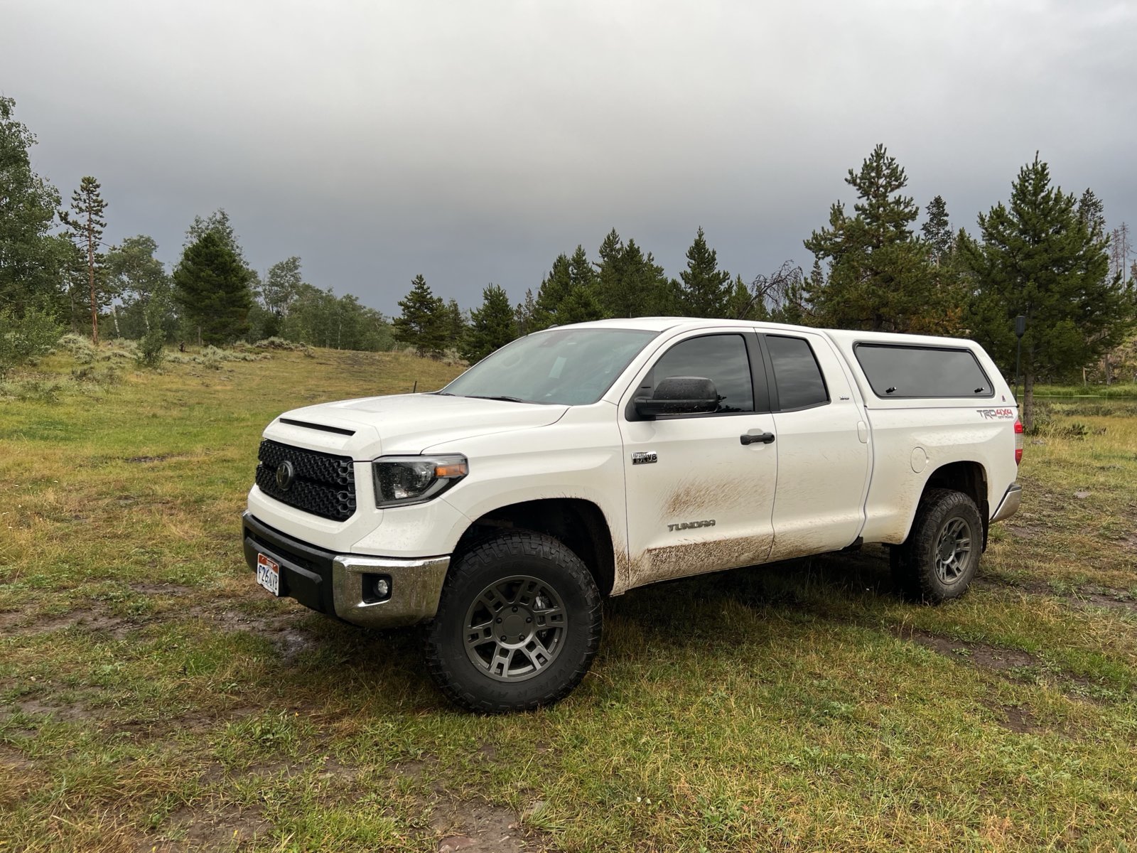

    I have 35’s on my 2.5 gen Tundra with 5:29 re-gear with lockers. It gets 11MPG city it sure is a lot faster city driving re-geared maybe 18MPG highway. The trans temp is lower and overall it has way more torque. But I've driven the new gen4 taco and its more powerful way more linear power. Kinda of made me hate my tundra on my camping trip right after driving the new Taco.
