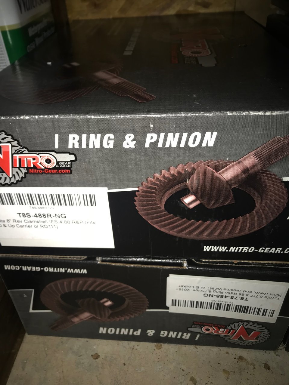

    I didn't count the teeth on the two sets of Ring/Pinions when I received them, or do anything other than sign for the delivery, put them in the bed of my truck and drive them down to the shop. Not meant to be cynical, at all - good question. I bought the gears from a 'group buy' on this forum, signed for the delivery when they finally came off backorder, and brought them to the shop to do the install.
    Part numbers on Nitro boxes: Front: "T8S-488R-NG" Rear: "T8.75-488-NG" Image Attached.

    FWIW - I just sent an email to the folks at SDHQ in Arizona, with a picture of the gears - asking them to confirm at least the labels indicate the right gears were purchased and supplied for the install. I'm going to assume (consciously) the gears from Nitro in the box matched the labels on the boxes.

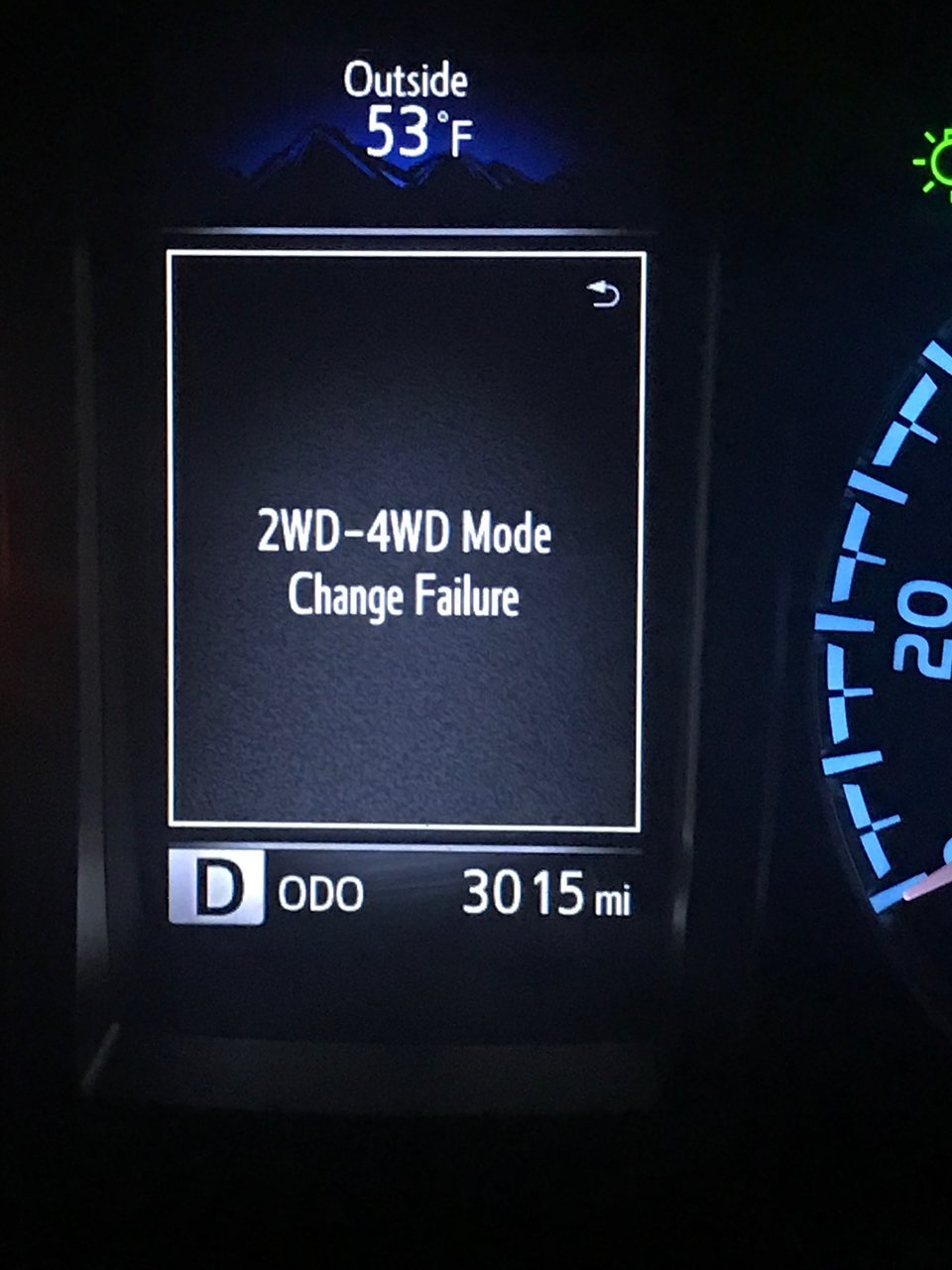

    The green light does not flash. I immediately get a graphic saying "2WD-4WD Mode Change Failure". Pic attached.
  18. Jan 16, 2018 at 8:05 AM
    #38
    Malibu7tss
    Malibu7tss Can' t think of anything to type here right now.
    Jan 26, 2016
    #176180
    699
    Central pa.
    2016 trd sport dcsb 4x4 bbp 6spd manual
    Old man emu with 888's and headstrong off road progressive aal, trd pro wheel, Cooper Stt Pros 285/70r17
    I'm going to say this is a damaged wire or sensor, and I am not sure how exactly the sensors read the wheel speed but there could also be a damaged pick up for the sensor. If the gears were wrong the truck would bind when it would finally go into gear. Depending on how close the ratio would be would determine how much bind, but you would notice it. Since it does noting for you it comes across as a fail safe in the truck.
