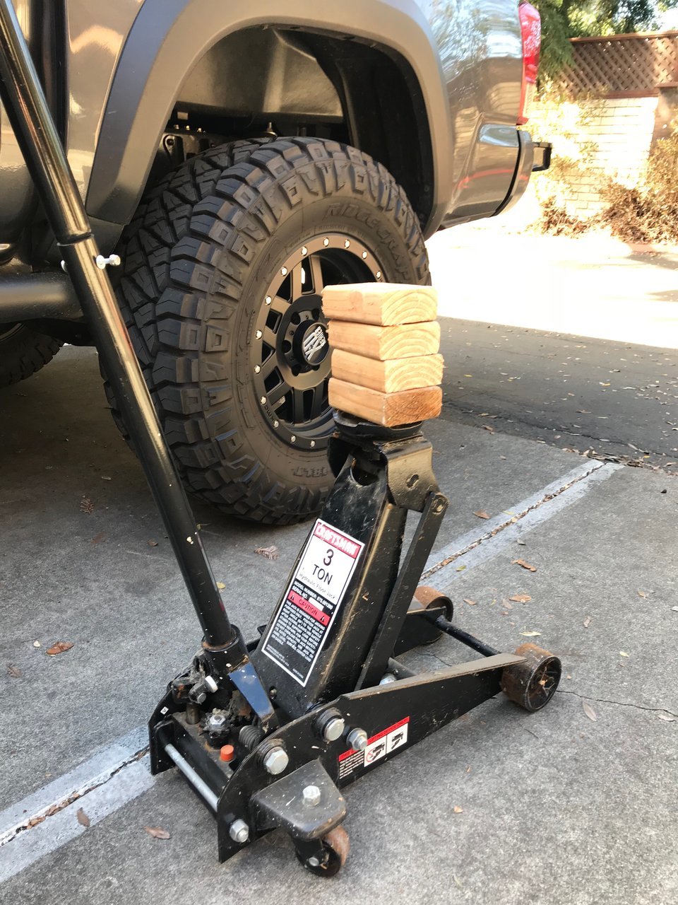

    And go figure, once you get a 6" lift on 35" tires, the old jack needs a little bit of help to git-er up. Oh yeah, totally safe. :-Q
