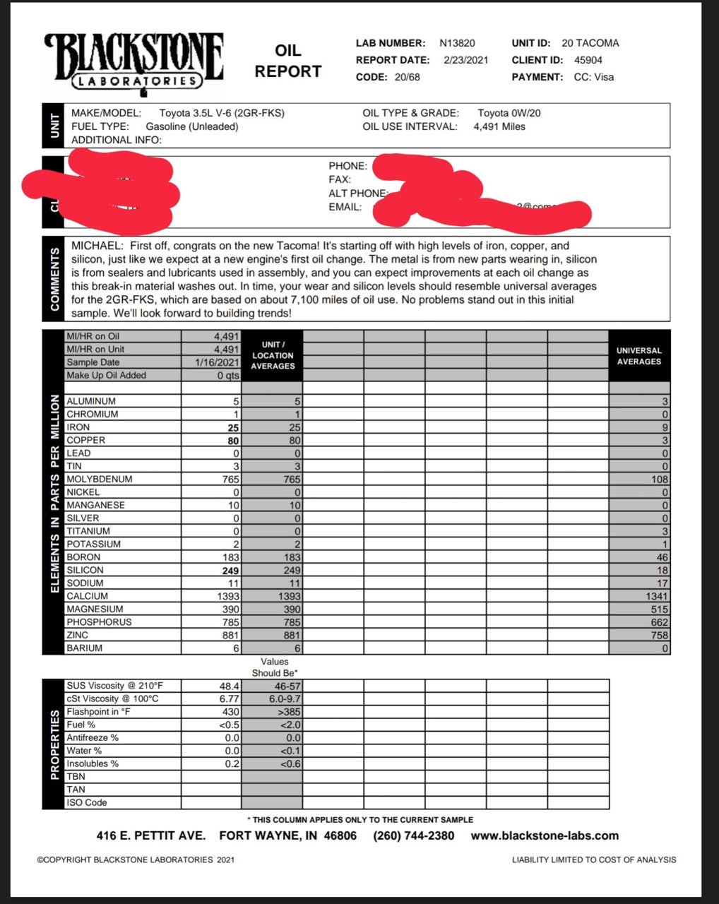

    OP's oil filter looked much like mine did at 4500 miles. I even had an oil analysis done too. I was doing this yearly with the Liberty CRD for about 10 years so very fumiluar with Blackstone labs.
    Definitely everything looks normal here's my oil analysis from the first oil change. Another will be done in a few months

    Look at the super high Moly content in the above posted analysis. It's there for a reason, and the longer you have it in there the better your engine breaks in. Off the shelf oils don't have that much Moly in them, not even close (if any). 1200 is a bit too early for my taste, but you can still add a can of MoS2 from Liqui Moly to substitute the loss of Moly.

    This moly is for your truck's pistons. Don't be selfish ;)

    I don't believe that is correct.
    Moly is an ANTI-wear additive designed to prevent wear. It is also a major component of assembly lube for just that reason.
    The question is if the factory fill is full of moly for a reason, or if when the motor is initially assembled they use assembly lube that contains a bunch of moly and hence your first flush is also full of moly. If its in the assembly lube then the purpose of the moly is gone within a few minutes (seconds?) of running.

    I know we are referencing the oil report I posted. Yeah the Moly is way high. I don't think I changed mine too soon. reasoning is that 5000 miles is the severe service schedule and I do some of the use behaviours to put me in that schedule. What I have seen and heard discussed is that most manufactures don't use a special breaking oil any longer, they just use the oil they spec for regular use in the engine. if that's so it would have been toyota's 0w20 that is likely made by Mobil. That would support the extra moly being from assembly lube which would not be washed out until the first drain interval.
    To each his own on oil change preferences. I think under a few thousand is too soon to change it but I'm no expert on cars, I've only owned and cared for several in my life for 5-10 years each and never lost one due to an oil related issue.

    Point being, if moly is in the assembly lube and not the oil then it isn't a component of the break-in-oil and just a byproduct of assembly that shows up in the first UOA. Leaving it (moly) in, or taking it out, likely does not change the break in in any way.
    Folks do lots of things with regards to oil and never lose an engine due to oil related failures. In fact its likely anyone here could follow either ends of any and all oil advice here on TW and never once experience any ill effects from doing so (well, maybe, this place is dumb so someone has likely argued for avocado oil around here). Oil life is massively overblown as a topic, and it is only done so because it is one of the very few items we can actually control on our vehicles. Far more vehicles would survive far longer with rust coating, driving lessons, or putting ones damn phone down, then will ever be by the oil arguments on any automotive forum.
