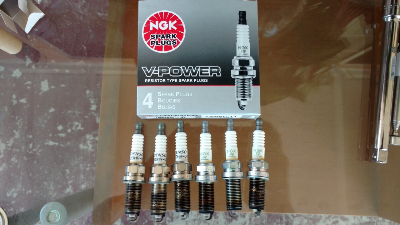

    I decided to swap out the spark plugs in my '15 Tacoma, took no more than an hour to do... But definitely saved myself some money by doing it myself. And of course all of you already know this about Toyota that it has two different brand of spark plugs installed by the dealer (NGK driver side and Denso on passenger side). Weird thing I noticed after removing the old spark plugs was that the NGKs wore out to .054-.056 and Denso all wore out evenly to .049 while the maintenance manual Gap settings is to be .043. maybe installed at different gaps? Or material durability between those spark plugs.... Another thing I noticed was that passenger side cylinders (1,3,5) are running rich in fuel mixture while driver's side cylinders 2,4,6 were running a bit lean... I wonder if Toyota does that for a reason.... But now I'm definitely looking into Dyno tuning my truckIMG_20180510_100939439.jpg

    i noticed too that the DENSO plugs hold their gap better than NGKs,and are slightly less expensive

    Yes, NKG plugs wore more then Denso. I did notice same thing when I replaced my spark plugs first time few years back. Last weekend after 35k miles i changed plugs again. These were all denso that I purchased on dealership 3 years ago. They looked just fine. Almost same as new ones I put in. anyway i dont mind doing it every 3-4 years. New plugs I purchased a months ago while I was shopping some other parts. Just waited some free time to do it.
