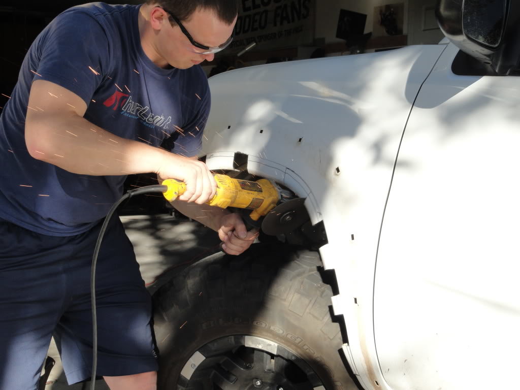

    I want to put 35"s on my 2nd Gen; I plan on doing this with a 3" lift. I was wondering if anyone has any knowledge, or, even better, pictures, of what cutting was necessary to fit the 35"s.
    The truck will be taken on tough trails (Moab, etc).
    Relentless did this with a "3.25inch lift". I see he cut the fender, but I would like to know what else must be cut?
    Pic from RelentlessTaco:
    Thanks!

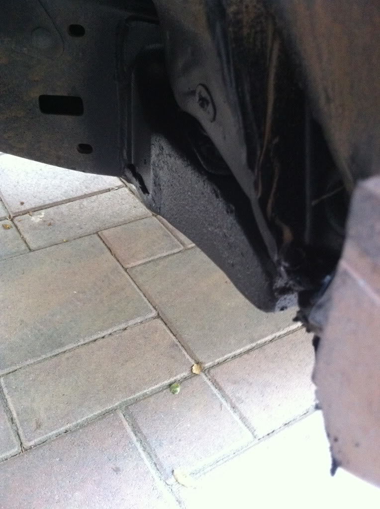

    cab chop, i dont think it would be possible with a stock bumper, the fender flare are going to want to come off, mine do right now with 285s. pinch weld modification and all kinds of trimming and cutting

    lets stress this first as well, these wheel wells are not large enough for 33s, it takes a lot to make enough froom for 33s so i cant imagine what it would be like for 35s

    the cab mount needs the be cut back.

    in the rear of the fenderwell there are mounts for the body cab and they come in contact with even 33 inch tires, lemme get a pick of the modification required

    Do you happen to know where I might find pictures of this?

    Which part has been cut? It's hard to see from the picture...

    the picture in my last post. It needs to be cut and a plate rewelded like in that picture, I dont have any of it original but just compare it to your truck.
