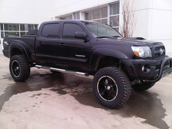

    OMG........NOW YOU'VE DONE IT.......I HAD MADE UP MY MIND AND THEN YOU GO AND POST A PICTURE LIKE THAT!!!!..............OK SO IS THERE A DIFFERENCE IN SUSPENSION FROM A 2005 TACO AND A 2011?!......IF THERE IS, WHAT IS IT? AND WHAT IS THE DIFFERENCE WITH THE STAGE 1 OR 2? IS IT BECAUSE UR RUNNING A STAGE 2 THAT IT DOESN'T RUB?!......

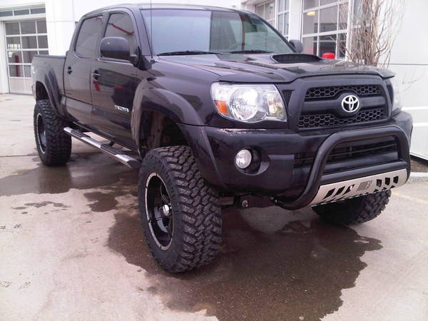

    The difference betwen the 2005 and 2011 suspension is that '11 you have to get a VSC lift or anything older then 2009 as VSC became a standard. I'm not sure if this makes a difference. The stage 2 seems to provide more lift then stage 1 due to the front coilovers that can be adjusted. I wonder if TruthINLies313 had the stage 1 thus the rubbing issues.
    Some people have said that since it's a 2011 the suspension hadn't settled yet but I've been seeing posts where people get new lift which includes coilovers and there was a lot of trimming right from the start. I've been driving it for a couple weeks and still no rubbing and trimming. the -12mm offset seems to help as well as the 4.5 inch bs. if i would of went with a more positive or negative offset then I might of had issues with rubbing.

    I can't guarantee it but the wheel and tire combination that I got seemed to clear better. I'm surprised as the 12.50 Nitto Trail Grapplers are actually 13.39 inches wide. I've seen 20's with 33's and they look great! It has to be the right tire and wheel combination though. An all black wheel like the Addict with Mud Grappler.
