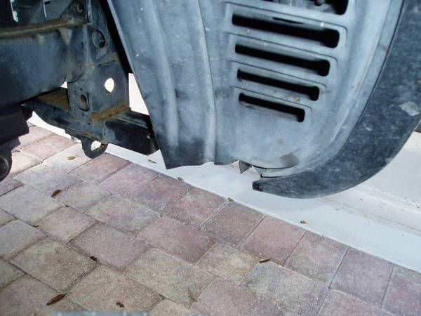

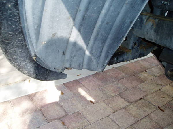

    Stay with the 35's...
    Start with a new razor knife blade, steady hand, very easy to do.
    Passenger Side Photo
  15. Dec 6, 2008 at 11:09 AM

    Drivers Side Photo

    After trimming about 2" I have zero rubbing. If you notice I cut at slight angle to maintain the integrity of the inner fender liner... so it does not flap going down the road.
