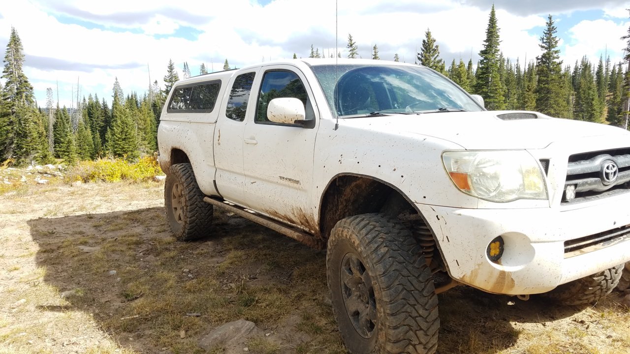

    ToyotaRoamer86
    ToyotaRoamer86 Well-Known Member
    Jun 20, 2017
    #221993
    520
    Brandon
    Frisco, CO
    2007 Tacoma TRD Sport
    35s 3", chopped cab and clearanced fenders

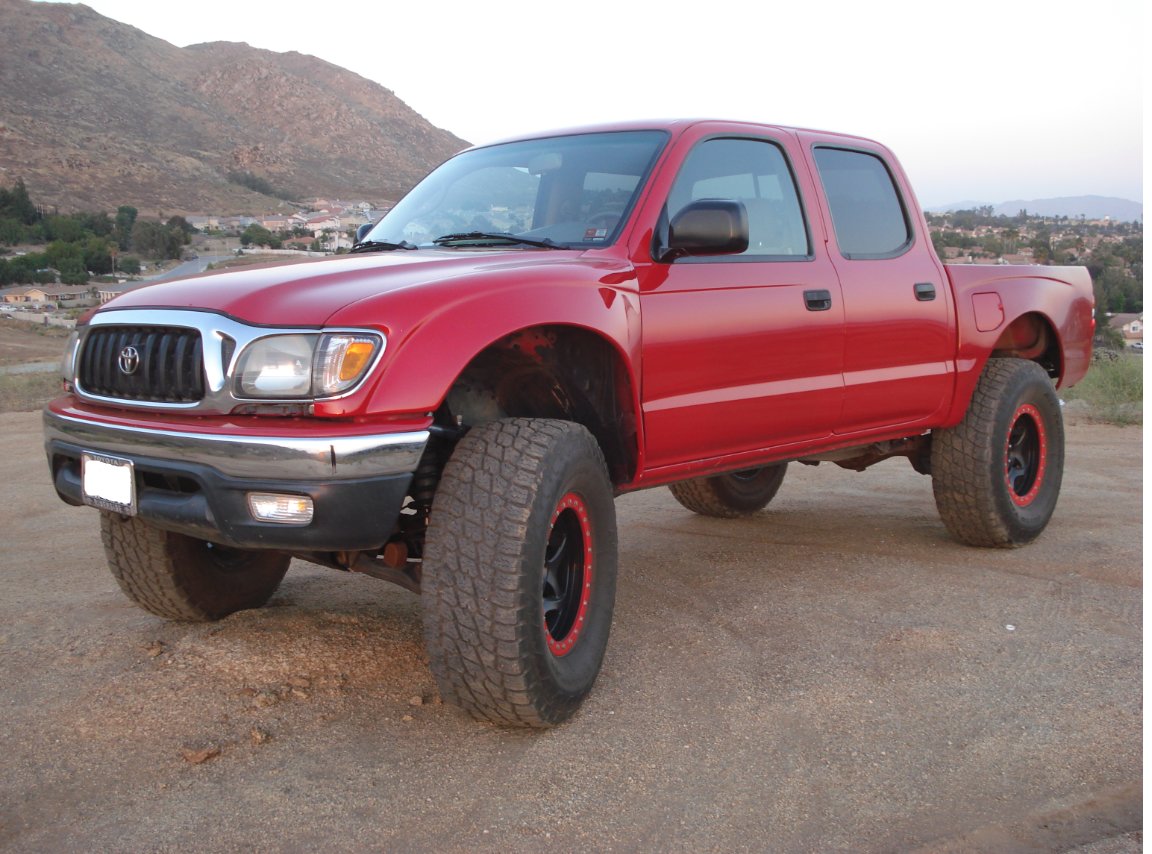

    @2steppin4x2 you can fit 35's on 0" lift. There are folks here who have done it. Stock height, with 35's.
    Lift doesn't change how the tires hit in the wheelwells or against the frame (unless you go long travel). A suspension lift, and even a body lift will still rub when the suspension articulates unless you go with long travel that completely changes the suspension geometry.
    So the question is: How much tubbing do you want to do?
