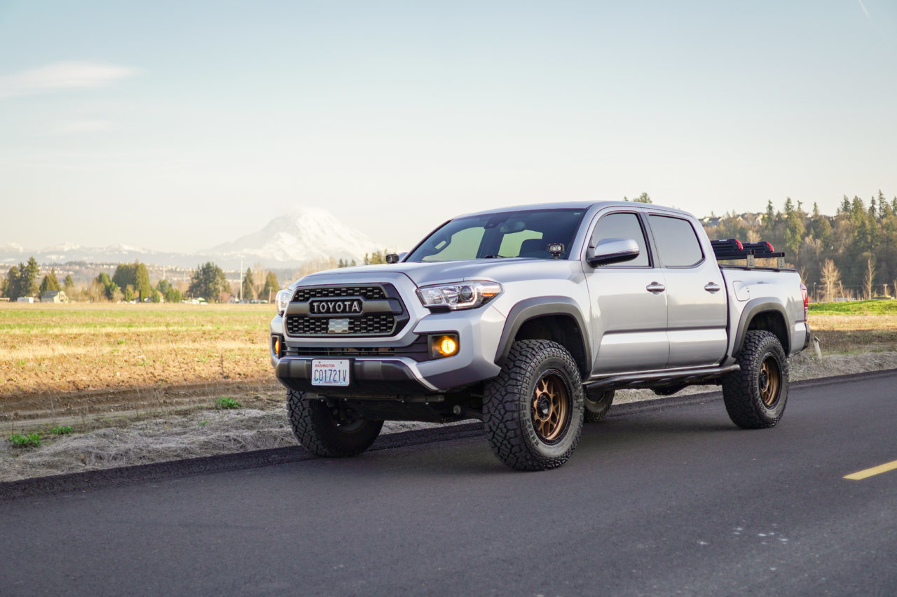

    Been running the 33x10.5 for the last 5,000 miles and they have been phenomenal. Up to the mountain passes about 5 days a week all winter and a couple wheeling trips. Just ordered the 35x10.5, should get them next monday. Leave for Moab next Thursday :thumbsup: ps I will have these 33s for sale once the 35s are on if anyone is interested, 5k miles on them, like new.
